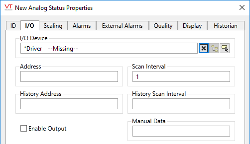

Analog Status properties I/O tab
The I/O Tab includes properties used to identify and establish a connection to the communication driver tag being used to exchange data with your physical I/O device (e.g. PLC or RTU), or to the polling driver responsible for determining the order and rate at which data polls will occur.
I/O configuration of an Analog Status tag
I/O Device
Select the communication driver tag from which data will be read.
By default, the tag will look for a parent tag that is a device driver (*Driver). If none is found, the text "--Missing--" will be displayed. The tag button to the right of the field opens the tag browser, from which you can either select an existing communication driver tag or add a new one. The X button will clear the field. Right-clicking on a tag in the field will open a dialog with which you can add or remove a Snapshot Expression or open a selected driver's properties dialog.
Address
Provide the address within the I/O device from which this tag is to read data. This value must match the configuration of your PLC or RTU hardware. Refer to the Addressing topic for your particular device driver for guidance.
If a Write Address is provided the Read Address is used only as feedback and will set the value of the tag regardless of the value written. If the value in the Read Address does not match the value written then the tag's Mismatch flag is set to true and will be reflected in linked widgets, either as a blink or a mismatch color, according to the widget.
Address Assist: (...)
Several drivers including SNMP, OPC Client, Fisher ROC and others, provide an Address Assist button to help you. The content of the Address Assist dialog will vary according to the driver.
Scan Interval
Provide the frequency, measured in seconds, at which the I/O device should be scanned for new data. Reduce system load by setting this as high as possible, as appropriate for the equipment being monitored. If the I/O Device is a Polling driver, which provides its own scan interval, then this field will not accept data.
History Address
If set, then the address field becomes optional. This field provides a means of reading values as recorded by a data logger.
If both the address and the history address are provided, then the address will be polled for data at the interval set by the Scan Rate, but the values read from the data logger will overwrite the values logged by this tag when it is updated.
The form for the history address will depend on the RTU. Please refer to the addressing reference chapter for your driver.
Note that it is not possible to enter a parameter expression directly in the History Address field. As an alternative, you may enter compound address in the Address field using a parameter expression. For example, if Addr, HistAddr and HistoryRate are all properties of a parent tag, the following expression in the Address field will create a compound address with all three components:
concat(.\Addr , "):(" , .\HistAddr , "):(" , .\HistoryRate )
The characters "):(" separate each component of the address. Do not add a leading or trailing parenthesis around the entire expression.
Further information on reading history information can be found in the topic SCADAPack History Read
History Scan Interval
Sets the time between polls of the history data logger. If a History address has been set, but this field is left blank, then it will default to the value set in the Scan Rate field. The recommended value for this field is 60 seconds. Lesser values may cause communications to slow down.
Note that it is not possible to enter a parameter expression directly in the History Scan Interval field.
Manual Data
Sets a constant value that will be used instead of live data. Use when testing a new tag if you need to check behavior when a value is outside the normal operating range. Tags that have manual data are marked by a flashing exclamation mark within any linked widgets. Logged values are marked with an exclamation. Always reset this to blank after testing.
Enable Output
If checked, this input tag may also be used to write data to the specified address of the communication driver. A Security Privilege may be set in the Quality tab to restrict access to this feature.

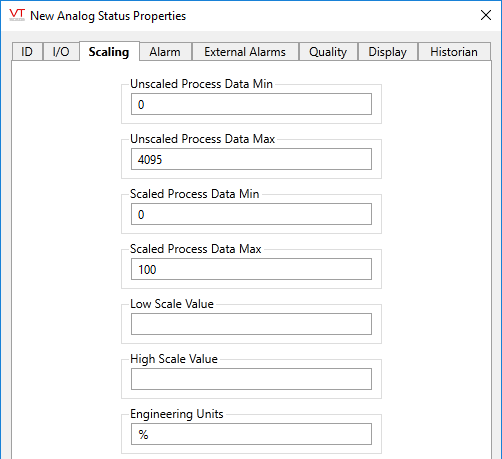

Analog Status properties Scaling tab
The Scaling Tab requires values that will be used to convert unscaled, raw data from the I/O device associated with this tag into scaled data that will be reported to operators.
Changes in value smaller than the Deadband setting will not be logged! Always check the settings in the Historian tab.
Analog Status tags will apply a default deadband of 1/4 of one percent of your display scale. (DefaultAnalogDeadbandFractionOfFullScale)
Read about the deadband in the section for the Historian Tab. Do not risk either a value so low that it logs system noise or a value so high that important information is lost.
Analogs can read text values if those are returned by the driver. Set the first four of the scaling parameters to "1" in order for the tag to interpret data as text.
Better is to use the String I/O tag for reading text data to avoid problems when attempting to mix text and numbers. A text "2" sent to an Analog Status with scaling set to 1 will be scaled to 1.
The first four fields on this tab affect the tag's value, scaling it from the input range to a desired output range.
The default value for each of these fields is stored in an application property. You are advised to change those properties to match the values used by your hardware by using the Edit Properties page of the Application Configuration dialog. You will need to use the Advanced mode of the properties page. The properties to copy and edit are:
- AnalogUnscaledMinDefault
- AnalogUnscaledMaxDefault
- AnalogScaledMinDefault
- AnalogScaledMaxDefault
VTScada assumes a linear relationship between the values as shown. The scaled and unscaled process values you provide set the slope of the line, allowing any value on one axis to be mapped to the other. The values do not limit what the tag can read, but the Scaled Process Min and Max values do limit what the tag can write. |
Low and High Scale Values
These two fields have no effect on the value of the tag. They do affect the deadband used for logging.
Set the Low and High scale values to define the default scale range for the HDV trend view and certain widgets, such as the various meters. Use these when values are expected to stay within a portion of the full-scale range and it is therefore helpful to adjust the displayed range as needed.
If left blank, the Scaled Process Data Minimum and Scaled Process Data Maximum values will be used as the Low and High Scale values.
Engineering Units
Provide the units of measure that the calculated value represents. This text will be used by widgets that include engineering units as part of the display. Possible values for this field include "rpm", "degrees C", "%", etc.
You can add a degree symbol to the engineering units by holding down the Alt-key while typing 0176 on the numeric keypad. Release the Alt-key before typing the C or F.

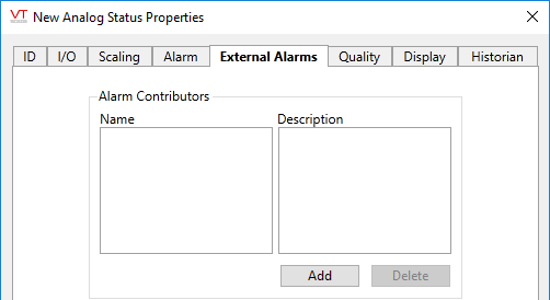

Analog Status properties External Alarms tab
Use the Add button to create new external Alarm tags and the Delete button to remove them. The new alarm tags will be created as children of the current tag.

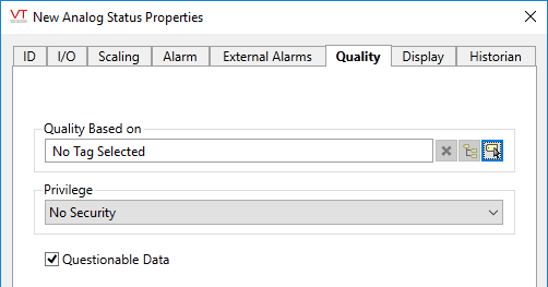

Analog Status properties Quality tab
The Quality Based On field can be tied to a driver tag, a tag that monitors driver communication errors, a register in the PLC or RTU, or any other indication of system health. The tag you are configuring will use that value to set an internal variable named QualityIssue. You may test this value in an expression: [TagName]\QualityIssue.
QualityIssue will be a 0 or 1 where "Good Quality" is defined as a value of "0 or Invalid" and "Bad Quality" is defined as any valid, non-zero value. This is consistent with driver communication error values.
Widgets that use the System Style tag will display bad quality using the color set on the Exceptions tab.
The Quality Based On field can also be used when this tag is to be a contributor to a custom-built container tag. Please see the topic, Merit tab and Quality tab, for details.

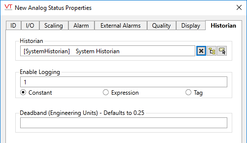

Analog Status properties Historian tab
Read the label of the deadband setting on your tag! Values smaller than the deadband setting will not be written to the Historian.
Historian
There are consequences if you change the selected Historian tag after you have begun collecting data. If you switch to a new Historian (perhaps for organizational or load sharing purposes), the data collected for this tag by the previous Historian will become inaccessible. Historian selection and configuration should be done during the project design stage.
Enable Logging
If values should be logged only while certain conditions are true, you can tie the Enable Logging option to any tag or expression that will change from zero (logging disabled) to non-zero (usually 1; logging enabled).
Analog Status Historian tab
Deadband (Engineering Units)
The value of an Analog Status tag is automatically logged on change. The deadband range, specified in the defined engineering units, sets a minimum amount by which the tag's scaled(*) data must change before a new value is written to the log file. This will dampen out minor changes of value, reducing the size of the log file by excluding system noise.
If the deadband value is not set explicitly, the deadband will be the difference between the high and low display scale values (set on the Scaling tab), multiplied by the value of the application property, DefaultAnalogDeadbandFractionOfFullScale. That property defaults to one quarter of one percent (0.25 on a range of 100). Note that display scale values, if not set, default to the minimum and maximum scaled process data values.
No default will be applied to legacy applications. You may choose to set a value.
