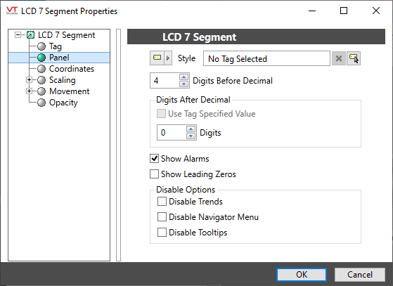

The properties dialog for the LCD 7 Segment widget:
Style
Optionally, select a Style Settings tag to control the colors shown by the light, in response to the linked tag's value and alarm state.
See:Style Settings Tags
Digits Before Decimal / Digits After Decimal
Sets the number of digits to display. Digits beyond the range of the tag's current value are shown in dim shade, as configured in the linked Style Settings tag.
If linked to an I/O and Calculation tag, you can choose to use the current Digits after Decimal setting from the tag's configuration instead.
Show Alarms
When selected, values that exceed alarm setpoints will be drawn in the Style Settings alarm color (usually red).
Show Leading Zeros
Must be selected in order for leading zeros to be included in the display.
