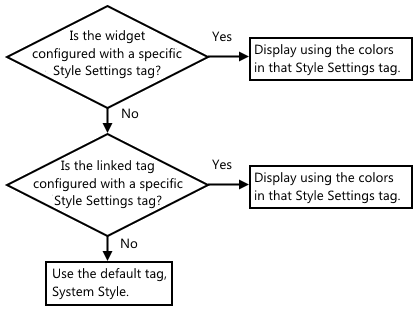

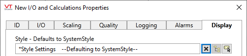

Many widgets and most tags can be configured to use a Style Settings tag. In the event that both a widget and the tag linked to it are configured with different Style Settings tags, the configuration of the widget takes precedence over the configuration of the linked tag.
"System Style" is the default, included with every copy of VTScada
Many widgets have a similar configuration. Note that this is not available in all widgets.
Style Settings choice in a widget. "No tag selected" means "whatever the I/O tag uses".
One default Style Settings tag, "System Style", is included in every new VTScada application. It will be used by every style-aware tag that has not been configured to use an alternative selection, including no Style Settings tag.

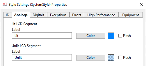

Fields in the Analogs tab of this tag are used to set colors and labels for LCD widgets.
Lit LCD Segment
When an LED indicator widget is used for a numeric display, the lit portion will have this color.
Unlit LCD Segment
When an LED indicator widget is used for a numeric display, the unlit portion will have this color, typically using an opacity value less than one.

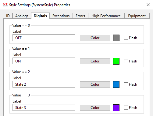

Style Settings properties Digitals tab
If your I/O tag has an Equipment type, configure the style using the Equipment tab rather than this tab.
The Digitals tab of this tag sets color and text for equipment / status widgets, indicator-lights and other style-aware widgets for digital tags.
The text parameter is used only by widgets that recognize the Style tag and that include text.
Value == 0
Set the text and color of the text, displayed when the associated tag is in the zero state.
Value == 1
Set the text and color of the text, displayed when the associated tag is in state one.
Value == 2 and Value == 3
For digital tags that use two address fields, and therefore can display up to four states, this label and color will be displayed when the associated tag is in state two.

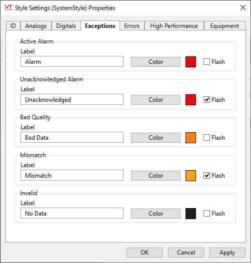

Style Settings properties Exceptions tab
Exceptions refer to alarm states, as displayed by those widgets that have alarm indication features. Note that these do not reflect the priority of the alarm.
The exception indicator will vanish when the alarm normalizes, even if that alarm has not been acknowledged. You can change this behavior by changing the property "AlarmWidgetsShowUnackedNormalAlarm" in the application's properties, setting the value to 1. (This property affects most widgets that indicate alarms using the Style Settings properties, with the exception of the Alarm Priority Indicator, Alarm Priority Box, and high performance graphics widgets.)
Active Alarm
Set the text and color of the text, displayed when the associated tag has an active alarm.
Unacknowledged Alarm
Set the text and color of the text, displayed when the associated tag has an unacknowledged alarm.
Bad Quality
Custom programming, using the VTScada scripting language, must be done to make use of the Quality field of a tag. If the associated tag is using the Quality field, the associated widget will use the label and color set in this field to indicate a bad quality value.
Mismatch
For output tags, if the feedback value for the associated tag does not match its current value, or value last written, this text and color will be displayed on the associated widget.
Invalid
Set the text and color of the text, displayed when the associated tag is in an invalid state. Invalid states usually indicate a break in communications, whether due to faulty configuration or communication.

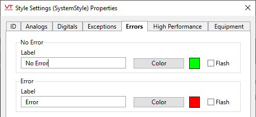

Style Settings properties Errors tab
The label parameter is not used by any VTScada widgets in this version.
The value property of tags in the ports group, drivers group, the Modem tag and the SMS Appliance tag, will indicate whether that tag is in an error state. When drawn using a Status Color Indicator or Indicator Light widget, the tag's value, which indicates the error state, will be shown using the colors and labels configured here rather than the colors defined in the digitals tab.
No Error
Color to be used when the linked tag is not in an error condition.
Error
Color to be used when the linked tag is in an error condition.

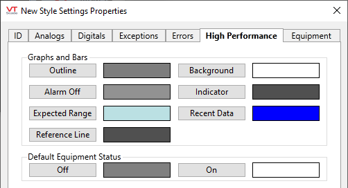

Style Settings Properties: High Performance tab
Properties set here control colors used in high performance HMI graphics such as the Spider Plot widget and HP Analog Bar.

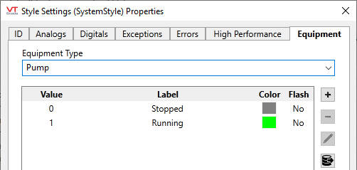

You can match properties of label, color and flash to any value that the tag may have. Refer to the following screen capture of the default configuration for a Pump type. A value of 0 in the tag maps to the label "Stopped" and the color gray. A value of 1 in the tag maps to the label "Running" and the color green.
If the tag has a value that is not included in the list, nothing is shown in the widget.

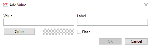

After selecting or creating an equipment type, create settings for the possible states by clicking the Add button
. This will open the Add Value dialog. If you attempt to define the same value twice for a given equipment type, you will be warned to choose another. You will not be warned if you leave a value out of a series, therefore it is best to enter values in order from lowest to highest. Values may be numeric or text.
Note that the default color is transparent.

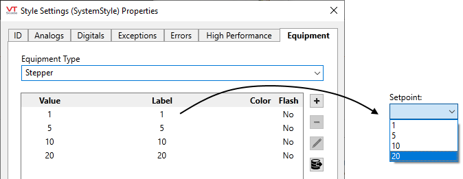

If the equipment type is used for an input tag, the label for each matching value can be displayed by using an I/O Multi-Text widget.
If for an output tag, then the values and matching labels can be used to configure the selections available in a Droplist Widget.
