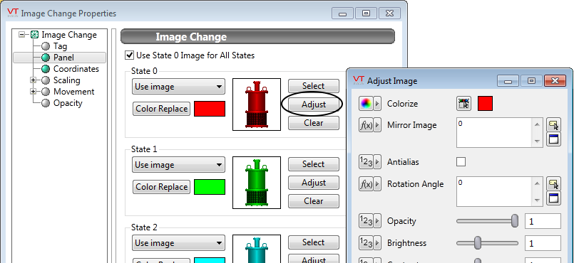

As of VTScada release 11.1, default settings for each image will colorize the entire image rather than the indicator area. This makes the Image Change appear to work the same as an Equipment widget without actually having a link to a Style Tag.
To configure an image change as was done in legacy applications (where only the indicator area would change color) click the Adjust button for each state, then click the Reset to Defaults button within the Adjust Image dialog. This will remove the colorization from the entire image.
Examples follow for each of these ways of using the Image Change widget.
  • Display a different color for each state:
The properties dialog configuration to produce these images is as follows. Note that the colors are applied by colorizing each state, rather than using a Style Settings tag.

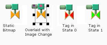

  • Represent the associated tag with a color-changing area positioned over areas drawn with active orange (RGB 255, 160, 0).

Use State 0 Bitmap for All States
Select this box if you wish to use the image selected for State 0 for all states of the tag.
This option is often used when the selected image's indicator area (the small rectangle at its base) is to be replaced with a new color according to the state of the tag.

If not using an image, you should select Color Replace, then position the Image Change over an area of Active Orange. Everything that is Active Orange below the Image Change will be replaced with the matching state's color.
Color Replace
Use the Color Replace option if the image includes a color indicator patch, or if you have selected the No Image option. (Color indicators patches must be areas of Active Orange.)

Image Adjust
Opens the Adjust Image dialog box, which can be used to change the color and other display characteristics of the image. See: Adjust Image Dialog
