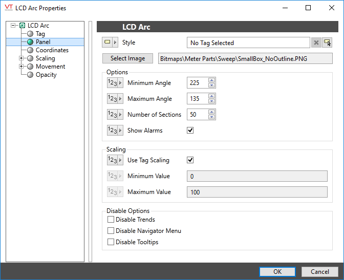

The properties dialog for the LCD Arc widget:
Optionally, select a Style Settings tag to control the colors shown by the light, in response to the linked tag's value and alarm state.
Minimum and Maximum Angles
Angles are measured clockwise from vertical. These two fields define the start and end points for LCD Arc's sweep.
Number of Sections
Controls the number of segments that will be shown within the meter's sweep. Defaults to 50, but should be reduced if a smaller sweep angle is defined.
Show Alarms
When selected, tick marks past the alarm set point will use the color configured in the style tag.
