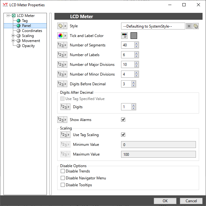

The properties dialog for the LCD Meter widget:
Optionally, select a Style Settings tag to control the colors shown by the light, in response to the linked tag's value and alarm state.
Tick and Label Color
Sets the color of the segments marks and scaling text around the meter. Defaults to gray <FF929292> so that the labels will be visible against a white background.
Number of Segments
The number of LCD tick marks displayed around the sweep of the meter. The meter will usually look best when this number matches (or is a multiple of) the number of Major Divisions times the number of Minor Divisions.
Number of Labels
Controls the number of text labels displayed around the meter.
The number of longer white lines around the meter.
The number of shorter white lines between each major division.
Digits Before Decimal & Digits After Decimal
These two parameters work together to define the number of LCD digits displayed in the numeric portion of the meter.
The display has room for a maximum of four digits. If adding a fourth digit before the decimal, you must remove the one following.
If linked to an I/O and Calculation tag, you can choose to use the current Digits after Decimal setting from the tag's configuration instead.
