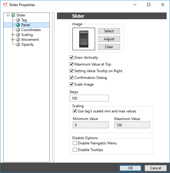

The properties dialog for the Slider widget:
Image Select
Opens the Select Image dialog, within which you can browse for images, import new images, and select the image to use.
* VTScada recognizes the following image formats: .BMP, .CUT, .PCX, .EMF, .WMF, .JPG, .PNG, .TIF
Image Adjust
Opens the Adjust Image dialog box, which can be used to change the color and other display characteristics of the image. See: Adjust Image Dialog
Image Clear
Remove the selected image and do not select a replacement.
Draw Vertically
Select this option if you want the completed Slider object to operate vertically. If you would prefer the Slider to operate horizontally, leave this box unselected.
Maximum Value at Top
When selected, moving the slider up (or to the right if Draw Vertically is not selected) will result in an increase of the value to write. Otherwise, values will increase towards the bottom or left as the slider moves.
Setting Value Tooltip On Right
When selected, a tool tip displaying the value to which the slider is being set, appears on the right of a vertical slider or above a horizontal slider. When not selected, the tooltip appears to the left of the vertical slider, below the horizontal slider.
This check box will be labeled Setting Value Tooltip On Top if the Draw Vertically check box is not selected.
Query Changes
If selected, the operator to be prompted for confirmation of any new value being set.
Scale Image
The Scale Image check box can be selected if you want the slider image to scale along with the overall widget. If not selected, the image will remain the same size and shape as the size of the overall slider is adjusted.
Steps
Sets the precision of the control, relative to the scaling value. The default value enables the operator to select 100 possible values within the scale range. Note that operators may have difficulty selecting a value if you set a large number of steps in a short slider.
Scaling Options
Choose whether to use the tag's minimum and maximum scaling values or to set alternative scaling values that will be applied to the output value.
