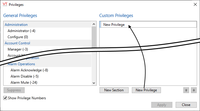

Add new privileges
Only users who possess the Administrator privilege can add new privileges.
To create or change custom privileges:
  1. Log in to the application using an account that has the Administrator privilege.
  2. Click your name (formerly labeled "Sign in").
  3. The Security menu expands.
  4. Click Privileges to open the Privileges dialog.
  1. Click the button labeled New Privilege.
    A data-editing field opens in the Custom Privileges list, pre-filled with the name "New Privilege".
Section of the Privileges dialog with numbers shown.
For instructions to suppress general privileges, see Suppress or Reveal Privileges
  1. Replace the default name with one that is appropriate for the privilege's purpose.
  2. Press the Enter key to save the new privilege name.
  3. You may repeat these steps for as many new privileges as required.
  4. Click the Apply button when done before closing the dialog.
Privileges are not granted automatically to any user account, including your own.

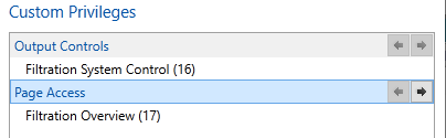

New section
Create named dividers within your list of custom privileges. This can be helpful for organizing privileges by purpose so that they are easier to find. The structure you create will also be used in the Add Privileges dialog when granting privileges to accounts or roles.
Privileges and sections can be reorganized using the up / down arrows at the bottom right of the list.
Sections can be indented so that they appear as sub-sections, using the left / right arrows
on the selected section.
Two custom privileges, each in its own section.
