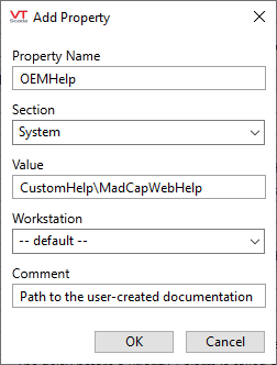

Name your output folder something like "CustomHelp" and copy it to the VTScada install folder (C:\VTScada\CustomHelp) - Open the Application Configuration dialog to the Edit Properties tab, Advanced Mode and add the following.
Note that the value must match your folder name followed by the key word \MadCapWebHelp as shown.

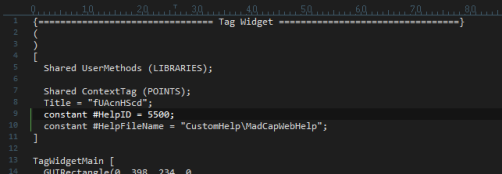

- To call your documentation from a page add the following line to the Main state of that page (using a text editor to edit the source code of that page. See: Scripting)
SetHelp(Self(), \Code\OEMHelp, 101);
Where 101 is replaced by your help ID number.

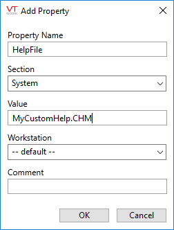

- Copy the .CHM file to the VTScada installation folder, not to the application folder.
- Use the advanced mode of the Edit Properties dialog to create a local copy of the property, HelpFile.
