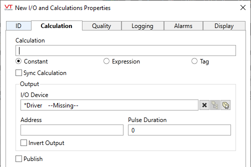

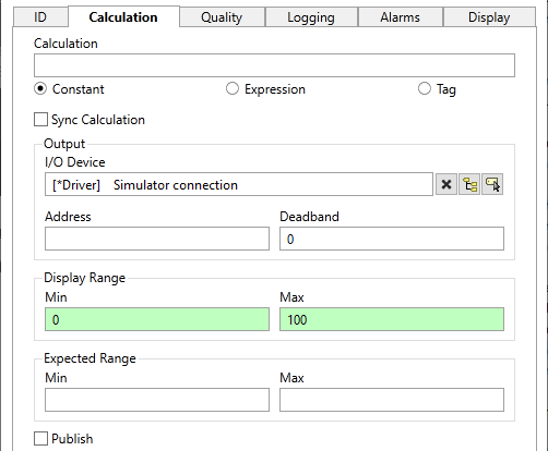

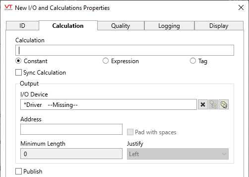

Calculation
For any data type, there is a Calculation option. This counts as a separate but matching mode for each listed in the drop-down. (So, Analog -> Analog Calculation)
Use this when you intend to create an expression that will be set the tag's value (or select another tag that this one should mirror). When creating a calculation, the choice of data type affects the values that can be returned by the expression and the set of widgets that can be used to display that value.
  • Calculation results can be written to an output address, in which case the tag will count towards your tag license.
  • Calculations that do not write to an output address do not count towards your license.
  • Any I/O tag with the Calculation mode set does not count as a memory tag. (Memory Tags)
  • Calculations do not retain their value across restarts. Use a legacy Analog Status (Analog Status Tags) or Digital Status (Digital Status Tags) if that feature is required.
  • In applications that run on multiple workstations, calculations are performed locally on each workstation unless the synchronize option (Sync) is selected. Either mode may be appropriate depending on the purpose of the calculation.
Mode Select when you need to...
Analog Calculation
Calculate a numeric value.
Does not read from hardware but may use the value of other tags that do.
Can write to hardware.
Discrete Calculation
Calculate a value from a set of known values.
Digital Calculation
Calculate a digital value.
Can write to hardware (1, 0, or pulse)
2-Bit Digital Calculation
Calculate a 2-Bit digital value. (0 to 3)
Can write to hardware (single address).
String Calculation
Calculate a text value.

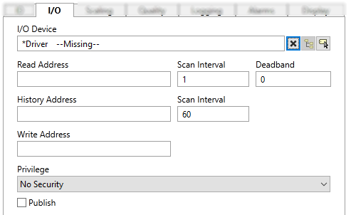

I/O tab for Analog and Discrete modes
I/O Device (Required)
Select the communication driver tag that data will be read from or written to.
By default, the tag will look for a parent tag that is a device driver (*Driver). If none is found, the text "--Missing--" will be displayed. The tag button to the right of the field opens the tag browser, from which you can either select an existing communication driver tag or add a new one. The X button will clear the field. Right-clicking on a tag in the field will open a dialog with which you can add or remove a Snapshot Expression, or open a selected driver's properties dialog.
Read Address (Optional.)
Provide the address within the I/O device from which this tag is to read data. This value must match the configuration of your PLC or RTU hardware. Refer to the Addressing topic for your particular device driver for guidance.
If a Write Address is provided the Read Address is used only as feedback and will set the value of the tag regardless of the value written. If the value in the Read Address does not match the value written then the tag's Mismatch flag is set to true and will be reflected in linked widgets, either as a blink or a mismatch color, according to the widget.
Address Assist: (...)
Several drivers including SNMP, OPC Client, Fisher ROC and others, provide an Address Assist button to help you. The content of the Address Assist dialog will vary according to the driver. Within this guide, refer to the Driver Addressing topic for your Communication Driver Tags for more information.
Scan Interval (Read scan interval. Applies only if a Read Address is provided.)
Provide the frequency, measured in seconds, at which the I/O device should be scanned for new data. Reduce system load by setting this as high as possible, as appropriate for the equipment being monitored.   If the I/O Device is a Polling driver, which provides its own scan interval, then this field will not accept data.
Deadband (Read deadband. Optional. Not present for String data type)
Feature not yet implemented.
Changes in value smaller than this (after scaling for Analog and Discrete types) are ignored by the tag.
History Address (Optional. Use only with devices that support this feature.)
If set, then the Read address field becomes optional. This field provides a means of reading values as recorded by a data logger.
If both the read address and the history address are provided, then the read address will be polled for data at the set interval, but the values read from the history address will override the values logged from the read address.
If the identical address is provided for both read and history, then only the read address is used. History values will not be recorded.
The form for the history address will depend on the RTU. Please refer to the addressing reference chapter for your driver.
Typically, history data arrives as an array. If sent to the Read address of an input tag, only the first element is read and the rest discarded. History data must be sent to the History address in order to be fully recorded.
Note that it is not possible to enter a parameter expression directly in the History Address field. As an alternative, you may enter compound address in the Address field using a parameter expression. For example, if Addr, HistAddr and HistoryRate are all properties of a parent tag, the following expression in the Address field will create a compound address with all three components:
concat(.\Addr , "):(" , .\HistAddr , "):(" , .\HistoryRate )
The characters "):(" separate each component of the address. Do not add a leading or trailing parenthesis around the entire expression.
Further information on reading history information can be found in the topic SCADAPack History Read
For numeric values (not String), a deadband is applied automatically to the values read on the History Address. The calculation uses the application property, DefaultAnalogDeadbandFractionOfFullScale.
CalculatedHistDeadband = PickValid(Threshold, (HighScaleValue - LowScaleValue) * \DefaultAnalogDeadbandFractionOfFullScale, 0);
Scan Interval (History scan interval. Applies only if a History Address is provided.)
Sets the time between polls of the history data logger. If a History address has been set, but this field is left blank, then it will default to the value set in the Scan Rate field. The recommended value for this field is 60 seconds. Lesser values may cause communications to slow down.
Write Address (Optional. Do not configure for tags that are input-only.)
Provide the address within the I/O device to which this tag is to write data. This value must match the configuration of your PLC or RTU hardware. Refer to the Addressing topic for your particular device driver for guidance.
For some drivers (SNMP and the OPC Client) an address browser is provided to assist you.
Privilege (Applies only if a Write Address is provided)
Limit the ability to write using this tag to only those operators who have been granted the selected custom privilege. See: Restrict Access to Output Tags
Publish
If selected, this tag's data will be available to any of:
  • An OPC client when your application has a properly-configured OPC Server Setup tag.

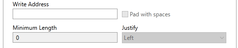

I/O Tab, String data type layout
Variation for Strings, showing options for output padding.
Pad with spaces
Enabled only after a Write Address has been entered. If selected, you will have the option of specifying a minimum length for output strings. Values shorter than this will be padded with spaces according to the selected Justify option.
Minimum Length
Enabled only after Pad with spaces is selected. Sets the minimum length for output strings.
Justify
Controls whether spaces are added to the left, the right or both sides of output text in order to achieve the required minimum length.

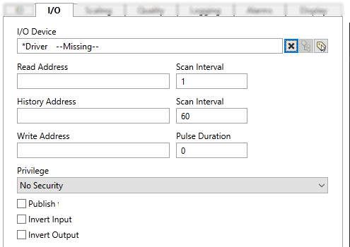

I/O Tab, Digital layout
I/O tab for the Digital data type
Variations in this mode are as follows:
  • No Deadband values
  • Addition of the Invert Input and Invert Output
  • Addition of a pulsed output option
Pulse Duration
The pulse duration can be no less than 0 and no greater than 86400 (one day)
When set to a positive, non-zero number, the tag will a specified signal (1 or 0) to the Write Address, then retain that value for the number of seconds specified by the duration. At the end of that time, the opposite value is sent to the write address and the tag's value returns to its normal state.
For example, if a linked button widget is configured to write a 1, this tag will write the value 1 when the button is pressed and will hold the value 1 for the specified duration. At the end of the duration, a 0 is written and the tag's value returns to 0. Writing a zero using a second button linked to the same tag has no effect, except in the case that a pulse is in progress, in which case it will cancel the pulse.
If Invert Output is selected, then this tag's base state is 1 and it can be used to write a 0 (zero).
Triggering a pulse repeatedly will reset the timer with each press of the button. This allows a long pulse to be sent, but the pulse following the last button press will be no longer than the set duration.
Invert Input
If the Invert Input check box is selected, the value of the tag being used as the data source is reversed (i.e. a 1 becomes a 0 or a 0 becomes a 1).
Invert Output
If selected, the normal state of the tag will be 1 and it will write a 0.

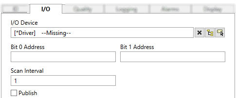

I/O and Calculations tag properties: ID tab version 2
Used for: 2-bit Digital
2-bit Digitals can only read. Do not use for tags that must write. There is no option to read from a History address with a 2-bit Digital.
The reported value is the data at the Bit 0 address plus two times the data at the Bit 1. If the Bit 0 Address field does not contain a valid address, this tag will not read.
I/O tab, only for 2-bit Digitals
I/O Device (Required.)
Select the communication driver tag from which data will be read.
By default, the tag will look for a parent tag that is a device driver (*Driver). If none is found, the text "--Missing--" will be displayed. The tag button to the right of the field opens the tag browser, from which you can either select an existing communication driver tag or add a new one. The X button will clear the field. Right-clicking on a tag in the field will open a dialog with which you can add or remove a Snapshot Expression or open a selected driver's properties dialog.
Bit 0 Address (Required.)
The Bit 0 Address property is the address of the low order bit for this tag in the I/O device.
Bit 1 Address (Required.)
The Bit 1 Address property is the address of the high order bit for the digital input in the I/O device.
Address Assist
Several drivers including SNMP, OPC Client, Fisher ROC and others, provide an Address Assist button to help you. The content of the dialog will vary according to the driver. Within this guide, refer to the Driver Addressing topic for your driver for more information.
Scan Interval (Required.)
Publish
I/O and Calculations tag: Calculation tab
Used for: All Calculation modes
There are three versions of this tab, depending on the data type of the tag. Select the one you are interested in from the following drop-downs.
It is important that the calculation expression match the data type. For example, a digital calculation expression should have a value of 0 or 1. Proper behavior cannot be guaranteed unless the result matches the tag's data type. For example, a text expression for a discrete data type will resolve to an Invalid.
If the Sync Calculation option is not selected, Calculations are performed locally on each machine running the application and are not synchronized between machines.
Calculation
Holds the expression that this tag should calculate. (Expressions) While you can specify a constant or select another tag to mirror it's value, in most cases you will select the Expression option, then click on the button in order to open the expression editor.
In calculation mode, the I/O tag does not retain its value across application restarts. If this is required, use the legacy Analog Control Tags.
Sync Calculation
The default is for calculations to be done on each local machine. If Sync Calculation is selected, the calculation is performed only on the current server and the value broadcast to other machines. "Current server" means the server for the parent driver tag, if there is one. Otherwise, it is the server for the Network Values service.
I/O Device (Optional)
Address (Optional)
Deadband (Numeric and Discrete Calculation only. Optional.)
Changes in value smaller than this are not written by the tag.
Expected Range - Min and Max (Numeric and Discrete Calculation only. Optional.)
Used to provide default minimum and maximum values to certain widgets. (The Numeric Calculation type does not have a scaling tab, where these values would otherwise be set.)
Pulse Duration (Digital Calculation only. Optional)
An important distinction from the Digital data type is that the calculation tag’s value does not return to its original state once the pulse its done (just the written value). To reset the pulse for a digital calculation, the expression’s value must go to 0 and then back to 1. This means that triggering a pulse repeatedly does not create a single long pulse, as in the normal digital case.
Invert Output (Digital Calculation only. Optional)
If selected, the a calculated state of the tag of 1 write as 0.

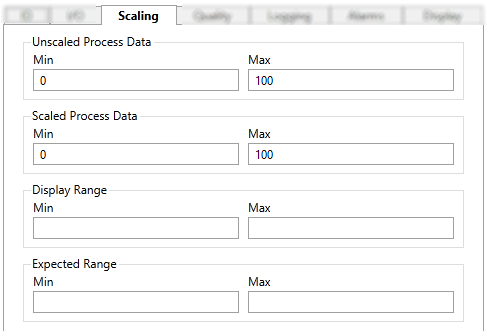

I/O and Calculations tag: Scaling tab
Used for: Analog and Discrete
Only the first four fields affect the value.
I/O scaling illustrated
VTScada assumes a linear relationship between the values as shown. The scaled and unscaled process values you provide set the slope of the line, allowing any value on one axis to be mapped to the other.
The values do not limit what the tag can read, but the Scaled Process Min and Max values do limit what the tag can write.
Min and Max Unscaled Process Data (Required.)
Use these to tell VTScada the range of raw values to expect from or write to hardware.
Min and Max Scaled Process Data (Required.)
Values must correspond to the Unscaled Min and Max values. VTScada uses these to convert between engineering units displayed in the SCADA system and raw values read from or written to hardware.

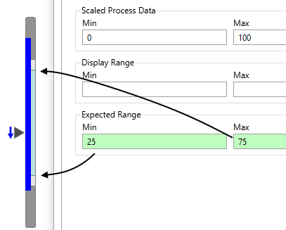

Display Range Min and Max (Optional.)
These two fields have no effect on the value of the tag.
Set the Min and Max Display Range values to define the default scale range for the HDV trend view and certain widgets, such as the various meters. Use these when values are expected to stay within a portion of the full scale range and it is therefore helpful to adjust the displayed range as needed.
If left blank, the Scaled Process Data Min and Max values will be used as the Display Range values.
Expected Range Min and Max (Optional.)
Used to provide default minimum and maximum values to certain high performance graphics widgets. If left blank, the expected range feature of those widgets is not drawn. Both must be provided.
The expected range is shown in pale blue.
The color is controlled by the assigned Style Settings tag.

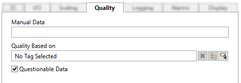

I/O and Calculations tag: Quality tab
Used for: All types
Quality tab for all types.
Manual Data
Sets a constant value that will be used instead of live data. Use when testing a new tag if you need to check behavior when a value is outside the normal operating range. Tags that have manual data are marked by a flashing exclamation mark within any linked widgets. Logged values are marked with an exclamation. Always reset this to blank after testing.
Quality Based on
The Quality Based On field can be tied to a driver tag, a tag that monitors driver communication errors, a register in the PLC or RTU, or any other indication of system health. The tag you are configuring will use that value to set an internal variable named QualityIssue.  You may test this value in an expression:  [TagName]\QualityIssue.
QualityIssue will be a 0 or 1 where "Good Quality" is defined as a value of "0 or Invalid" and "Bad Quality" is defined as any valid, non-zero value. This is consistent with driver communication error values.
Widgets that use the System Style tag will display bad quality using the color set on the Exceptions tab.
Questionable Data
Use the Questionable Data parameter to flag this tag’s data in the event that you suspect the values it is reporting might not be accurate, or when this tag has initially been created and you wish to ensure that its data is marked for extra monitoring.

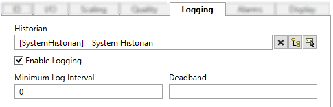

I/O and Calculations tag: Logging tab
Used for: All types
Logging tab for all types
Historian
If an Historian tag is selected, this tag's run-time values will be saved for use in reports and the Historical Data Viewer. Historian configuration and advanced logging options are described in the discussion of the Historian Tags.
If your goal is to disable logging, set the Enable parameter (below) to 0 rather than deleting the Historian parameter.
There are consequences if you change the selected Historian tag after you have begun collecting data. If you switch to a new Historian (perhaps for organizational or load sharing purposes), the data collected for this tag by the previous Historian will become inaccessible. Historian selection and configuration should be done during the project design stage.
Enable Logging
If values should be logged only while certain conditions are true, you can tie the Enable Logging option to any tag or expression that will change from zero (logging disabled) to 1 (logging enabled). Do so by right-clicking on the Enable Logging check box and creating a parameter expression. The "Optimize..." option in the expression should be deselected. For detailed instructions (and important warnings) see: Automated Tag Configuration.
Minimum Log Interval
Here, "Interval" refers to time measured in seconds. If set to a valid number greater than zero, and if the tag has a valid value, that value will be recorded to the history every interval, regardless of whether it has changed from the last write.
In most cases, this should be left blank, allowing values to be written on change larger than the specified deadband.
Deadband (Analog, Discrete, and matching calculation modes only)
Every change in value will be written to the Historian. You are advised to set a deadband so that you do not fill the log with small changes that amount to system noise.
When using the Analog data type, a default deadband of 0.25% of the scaled range is applied. This value is stored in the application property DefaultAnalogDeadbandFractionOfFullScale

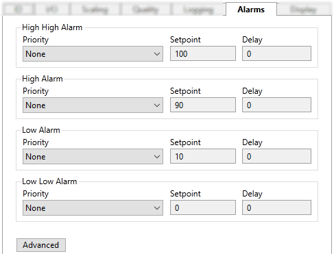

I/O and Calculations tag: Alarms tab (Basic analog type)
Used for: Analog, Discrete, and matching calculation modes
The basic version of this tab allows quick configuration of up to four alarms, two high-level and two low-level.
Unlike the legacy Analog Status tag, you do not need to enable the alarm as well as selecting a priority.
Do not configure an alarm for configurations that write but do not read.
Basic mode of the Alarms tab for analog values
Priority
Use the drop-down tool to select the priority for each alarm that will be triggered by this tag. The available priorities are:
  • None
  • 0 - Event
  • 1 - Critical Alarm
  • 2 - High Alarm
  • 3 - Warning Alarm
  • 4 - Notice Alarm
If you have defined your own Alarm Priority Tags, those will also be available for selection.
Setpoint
Sample setpoints are provided, based on the default scale values of the tag. You must change these to the setpoints at which an alarm should be triggered. To link the setpoint to another tag or an expression, use the Advanced version of this tab.
Delay
To avoid nuisance alarms due to transient spikes in value, set a delay in seconds. The tag's value must reach or pass the setpoint for this length of time before an alarm occurs. To set a deadband on the value, use the Advanced version of this tab.
State (Discrete)
The state for which the alarm will occur.

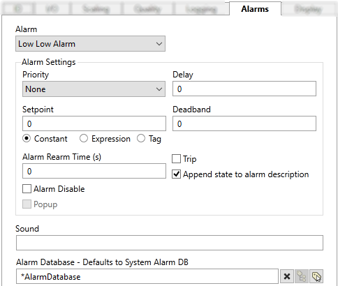

I/O and Calculations tag: Alarms tab (Advanced type)
Content varies. Used for: Analog, Discrete, Digital, 2-bit Digital, and matching calculation modes
For all the following descriptions, assume that for each data type, the matching calculation mode also applies. For example, what applies to Analog also applies to Analog Calculation.
For Analog and Discrete, after switching to the advanced tab, there is no option to switch back to the basic tab. If you use this tab to do any alarm configuration, the basic option will no longer be available. (If you close the properties dialog without doing advanced alarm configuration, then the basic tab will still be available the next time you open the dialog.)
The following figure is a composite of all possible parameters.
         No single version of the advanced Alarms tab includes all the parameters shown here.
A composite of all alarm parameters.
                   >> No single version includes all the parameters shown here <<.
Alarm (Analog, Discrete)
Select any of the four built-in alarms that are available for Analog and Discrete I/O types.
Alarm (Digital, 2-bit Digital)
The only available choice is "State", meaning that alarms are triggered by a change to a defined state value.
Priority (All types)
Use the drop-down tool to select the priority for the selected alarm. This will also enable the alarm.
Delay (All types)
Setpoint (Analog and Discrete)
The value at which the alarm will occur. An expression or tag can be used to create a variable setpoint for Analog or Discrete data types.
State (Digital)
Options include [0] OFF, [1] ON, or [Upon Change]
There is no option (other than a parameter expression) to use an expression or tag for this parameter.
State (2-bit Digital)
Options include [0] OFF, [1] ON, [2], [3] or [Upon Change]
Trip Alarm (Digital, 2-bit Digital)
Select if this alarm is to be a trip alarm. When triggered, a trip alarm is not affected by the changing status of the equipment.
For comparison, a "level alarm" has an active state (the level is at or beyond the trip point) and a normal state (the level has returned to normal operating conditions.) A trip alarm simply trips and does not monitor whether the cause returns to normal operating conditions.
After being tripped, all visible and audible notifications will continue until an operator acknowledges the alarm.
Append State to Alarm Description (Digital, 2-bit Digital)
When selected, VTScada will append the text used for the state of the tag, as taken from the list configured in the tag’s Display tab.
Deadband (Analog and Discrete)
Does not change the setpoint. Use this to avoid nuisance alarms that activate and normalize due to a value that fluctuates into and out of the alarm condition as defined by the type and setpoint. The level must drop (or high alarms) or rise (for low alarms) by this much past the setpoint before the alarm condition is considered to have normalized.
Alarm Rearm Time (All types)
Measured in seconds. If a valid, non-zero value is given then if the alarm has been acknowledged, but remains active for the time shown in this field, the alarm will return to the unacknowledged state. Audible and visible warnings configured for this alarm’s priority level, will again be displayed.
Does not apply if Trip is selected. (Digital types only)
Alarm Disable (All types)
Select to flag the alarm as disabled without changing other configuration. Disabling of alarms is typically used in situations where you wish to avoid false alarms. For example, in the event that routine maintenance is being performed on the equipment represented by this tag, or when you are aware that another interruption in communications will occur for a period of time. In such situations, the alarm can be disabled until the maintenance is complete and communications are reestablished.
Many sites like to tie this property to Digital tag so that many alarms can be disabled at the same time for maintenance. That option is not available with the built-in alarms, but you could use Alarm Tag instead.
Popup (All types)
The application property AlarmPopupsEnable must be set to 1 (Alarms Tab of the Edit Properties Page). If set, a pop-up dialog will be displayed whenever the respective alarm is triggered. This feature should be used sparingly.
Sound (All types)
The Sound field can be set to blank, 0, 1, or to the name of a .WAV sound file to be played.
  • If 0, no sound will be played when this alarm is triggered.
  • If blank or 1, an alarm sound whose properties are configured on the associated Alarm Priority tag will be played.
  • If the name of a .WAV sound file, it will override any alarm sound configured for the associated Alarm Priority tag. If the specified sound file is not found, the alarm will revert to using tones as specified in the associated Alarm Priority tag.
The .WAV file must be stored in the application folder and must be added to the application by using the Import File Changes Tool
Alarm Database
This tag will be linked to the first parent Alarm Database in the tag hierarchy. If none found, it will use the System Alarm Database.
Use this parameter to link the tag to an alternate Alarm Database of your choice.

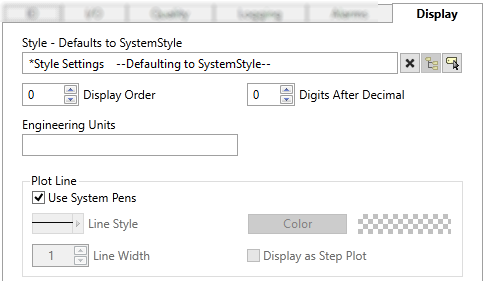

I/O and Calculations tag: Display tab
Layout and content varies by type
Display properties for analog data types including calculations.
                   Other data types will have fewer properties.
When this tag is represented on screen by widgets that can use a Style Settings tag, you can save development time by choosing the Style Settings tag that holds the correct display configuration for this tag instance. (See: Style Settings Tags)
The default configuration will search for the first parent tag of the Style Settings type. If there is none, it will use System Style, which is the default style tag that is automatically part of every new VTScada application.
Display Order
Common to all type selections. Used to specify the placement of this tag when viewed in a Site Details Page.
Digits After Decimal
Analog and Numeric Calculation. Limits the number of digits displayed after the decimal point wherever this tag is displayed, including the Historical Data Viewer. May be overridden in certain widgets.
Engineering Units ((Analog, Discrete, and matching calculation modes)
Provide the units of measure that the scaled value represents. This text will be used by widgets that include engineering units as part of the display. Possible values for this field include "rpm", "degrees C", "%", etc.
You can add a degree symbol to the engineering units by holding down the Alt-key while typing 0176 on the numeric keypad. Release the Alt-key before typing the C or F.
Plot Line
Options in this section control how this tag's pen is shown in the Historical Data Viewer (HDV) and widgets that support I/O tag features such as Sparklines.
Use System Pens
If selected (default) no pen configuration from this tag is made available to the HDV. Widgets that can take display characteristics from the linked I/O tag will have that option disabled.
Deselecting this option does not force the HDV or linked widgets to use display settings from this tag.
Default values are assigned for the following:
Line Style
Analog, Discrete, Digital, 2-bit Digital, Numeric Calculation. Default appearance of the line when plotted in any version of the Historical Data Viewer. Defaults to a continuous line. May be overridden in any plot. Options include a variety of dash and dot combinations.
Line Width
Analog, Discrete, Digital, 2-bit Digital, Numeric Calculation. Default width of the line when plotted in any version of the Historical Data Viewer. Defaults to a single pixel. May be overridden in any plot, up to 9 pixels.
Color
Select the color to use when representing this tag in the HDV.
Display as Step Plot (Enumerated data type)
Steps from one value to another will be vertical (or as close as possible) rather than include interpolated values.
