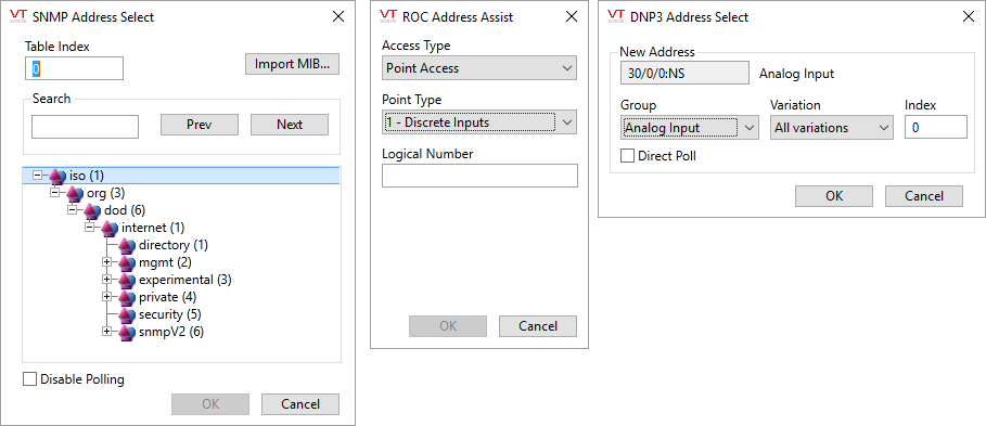

Many drivers support an "Address Assist" or "Address Select" dialog, which will be available as a button beside the Address field of all I/O tags using that driver. The content of the dialog will vary according to the driver. The one thing these dialogs have in common is that they will help you build addresses in the correct format. Note that the addresses cannot be populated until communication is established with the device.
Three examples of an I/O address assist.
