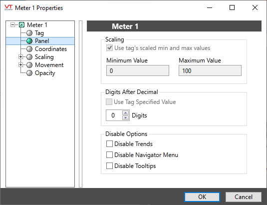

The properties dialog for the Meter 1 widget:
Low Scale Range and High Scale Range
Used to set the smallest and largest values to display on the meter. By default, these values will match the tag's scaled process values.
You can override those values to set your own scale range. For example, assume that you have a tag for which the minimum and maximum scaled process values are 20 and 80 respectively. Drawing this tag as a meter 1 with a low scale range of 0 and a high scale range of 100 will result in a meter that shows a full range of numbers from 0 to 100, but whose needle will move only between 20 and 80.
Digits After Decimal
Used to adjust the displayed accuracy of the meter. The displayed value will be rounded to the number of decimal points set. This is for display purposes only and has no effect on the tag’s value.
If linked to an I/O and Calculation tag, you can choose to use the current Digits after Decimal setting from the tag's configuration instead.
