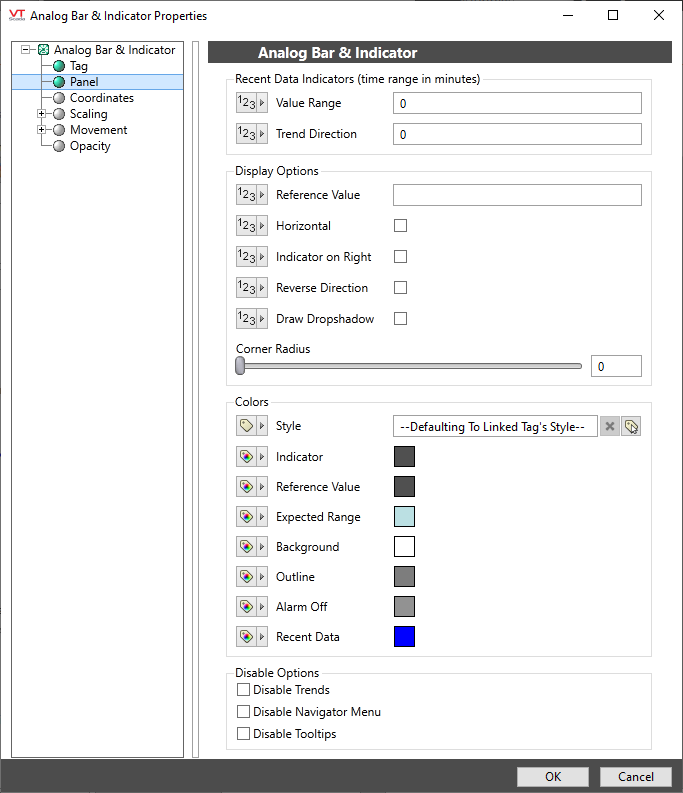

Configuration options for the Analog Bar and Indicator widget
All properties other than the corner radius and the disable options may be configured using numeric values, selected tags, parameters or expressions.
Recent Data Indicators
Value Range (minutes)
Sets the time span from which the minimum and maximum values are obtained, to be represented by the dark blue range bar.
Limited to a range between 0 to 525600 (1 year in minutes).
Trend Direction (minutes)
The current value of the linked tag is compared to the value at the start of the time span set with this property. If the current value is greater, the arrow indicates an increasing trend, otherwise a decreasing trend.
Display Options
Reference Value
A numeric value that represents the target setpoint of the tag whose history is being displayed by this widget. For example, if the bar and indicator widget represents a motor's speed, the reference value would be the output tag controlling that motor's speed.
This indicator is used only for display purposes. It is not an operator control. Limited to the linked tag's minimum and maximum values.
Horizontal
Controls whether the bar is drawn vertically or horizontally
Indicator on Right / Indicator on Bottom
For vertical bars, controls whether the indicator is drawn on the left or right. For horizontal bars, controls whether the indicator is drawn on the top or the bottom.
Reverse Direction
Flips the widget to its mirror image. If vertical, values would increase towards the bottom of the page. If horizontal, values would increase towards the left of the page.
Draw Drop Shadow
Adds a shadow effect to the bar.
Corner Radius
Use to soften the corners of the bar.
Colors
Refers to the selected Style Settings tag. If you have not selected otherwise, the default System Style Settings tag is used.
All other colors
These default to the configuration of the Style Settings tag, but may be overridden for a specific Bar and Indicator widget.
