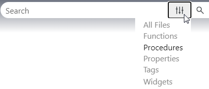

Use the filter button to limit the range of the search. If no results are returned, check that you are searching on All Files, rather than a filtered subset. If there are still no results, try a synonym for the term. Searching for a term used by some other SCADA program will often return the closest equivalent concept used in VTScada.
