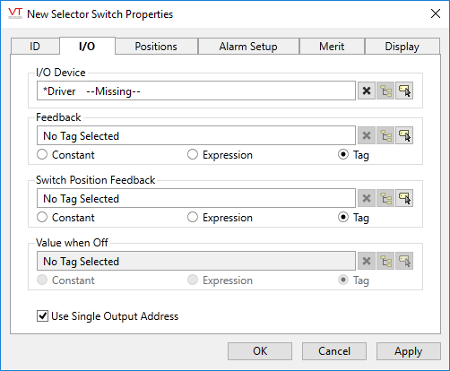

I/O configuration for a Selector Switch
I/O Device
Select the communication driver tag to which data will be written.
By default, the tag will look for a parent tag that is a device driver (..\*Driver). If none is found, the text "--Missing--" will be displayed. The tag button to the right of the field opens the tag browser, from which you can either select an existing communication driver tag or add a new one. The X button will clear the field. Right-clicking on a tag in the field will open a dialog with which you can add or remove a Snapshot Expression, or open a selected driver's properties dialog.
Feedback (equipment feedback)
[Optional] Select the tag or expression that has been configured to provide feedback indicating whether the control action of this switch has been successful. "Success" means that the state of the equipment matches what is expected (as configured on the Positions tab) for each possible switch position. A mismatch in values here will trigger an alarm, if one is configured on the Alarm Setup tab.
Switch Position Feedback
[Optional] Select the tag or expression that has been configured to provide an indication of the current position of the equipment. (0, 1 or 2 according to switch positions) The selector switch will change positions to follow this feedback value. If the selector switch is changed, but the feedback value does not follow, the widget will blink, but this will not by itself cause an alarm. See Feedback (equipment feedback).
Value When Off
Available only when the Use Single Output Address option has been deselected. The value provided here will be written to the addresses of the unselected switch positions after the current position's value has been written.
This check box provides an option to use a single output address for all switch positions, or to allow a separate address for each position.
In the case where each position of the switch writes to a different output address, you can deselect the "Use Single Output Address" box and provide a value that will be written to each address not matching the current switch position. Note: Addresses are specified on the next tab, Positions.
Values will be written in a "make before break" order. In other words, the value for a new switch position will always be written before the value-when-off is written to the addresses matching the unselected switch positions

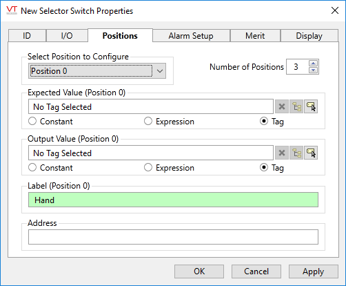

Selector Switch properties Positions tab
In the Positions tab you can configure the expected feedback values, the values to write and the address(es) corresponding to each of the possible switch positions. (Whether a single or multiple output addresses are used, depends on the check box in the I/O panel.)
Select Position to Configure
Select each of the available switch positions to configure the output and expected values for that position. The label over each parameter will change to show which position is being configured. The list is controlled by the parameter, Number of Positions.
Number of Positions
May be either "2" or "3". Limits the number of configurable positions in the switch. Always select "2" for a toggle switch. (This differs from earlier versions where it was common practice to create toggle switches by configuring positions "0" and "2," leaving position "1" blank.)
Expected Value (Position x)
Specify the value that is expected to be returned in the feedback field of the I/O panel, to indicate that the tag's switching operation caused a successful change in the system. This value can be a constant, an expression, or it may come from a tag.
Output Value (Position x)
This field is where you to specify the constant, expression or tag value that will be written to the output address when the corresponding position is selected. If a tag or expression is used here, then changing output values will trigger a write to the device as long as the position has not changed.
Label (Position x)
If the switch requires operator confirmation (configured when drawing the switch as a toggle) then this label will appear as part of the confirmation prompt for the matching switch position.
Address
The I/O address to write the output value to when position x is selected.
If the Use Single Address option was checked in the I/O panel, then this field will be labeled simply "Address" since the same address is used for all positions. Otherwise, the label will be "Address (Position x)" to indicate which switch position you are providing the address for.

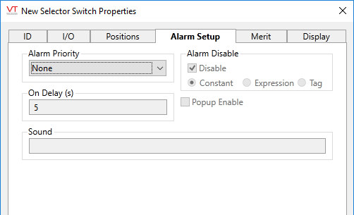

Selector Switch properties Alarm Setup tab
Specify the parameters of the alarm that will be triggered when the equipment feedback for the tag does not match expected value.
Because physical equipment can sometimes take a few moments to respond, a delay can be specified to prevent the alarm from being triggered while waiting for the expected feedback value.
By design, this alarm cannot be configured as a trip alarm.
Invalid data, whether on the I/O Device or a feedback tag, will neither cause nor clear an alarm condition.
Alarm Priority
Select the priority level of this alarm. All other controls are disabled while the priority level is set to "None".
On Delay
Specify a delay in seconds to wait when the feedback value from the PLC does not match the expected value for the requested switch position before triggering an alarm.
Sound
[optional] Enter the name of a .wav file in your application directory to use that as the alarm sound.
Alarm Disable
Deselect to enable alarms on this switch. May be linked to a tag or expression for suppression by design.
Pop-up Enable
Available only when alarm pop-ups are enabled in the application properties (see: AlarmPopupsEnable)

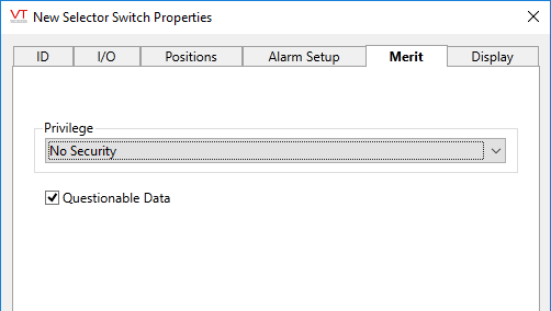

Selector Switch properties Merit tab
Privilege
