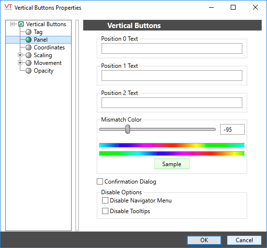

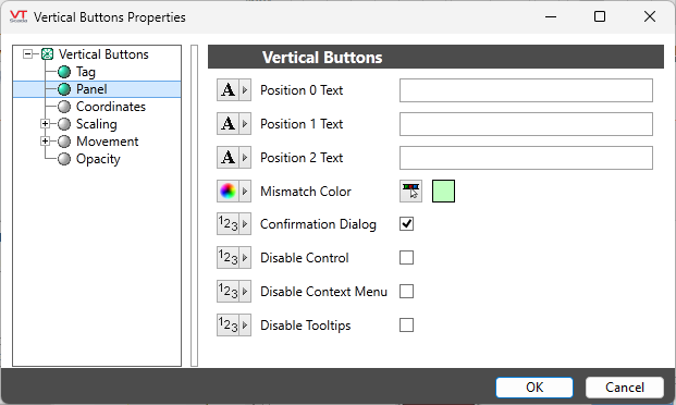

The following image shows the properties dialog where you can set the properties of the object.
Position Text n
Set the labels that will appear on the buttons. The buttons are drawn from top to bottom and match the Position 0 through Position 2 settings of the associated selector switch.
Mismatch Color
Use the slider to set the color that will be superimposed on a button in the event of a position mismatch in the selector switch. A sample image displays the result as you adjust the slider.
Confirmation Dialog
If selected, the operator will be prompted to confirm every change made by clicking on the buttons. See also: Confirmation Prompts for Output Tags.
Disable Options
