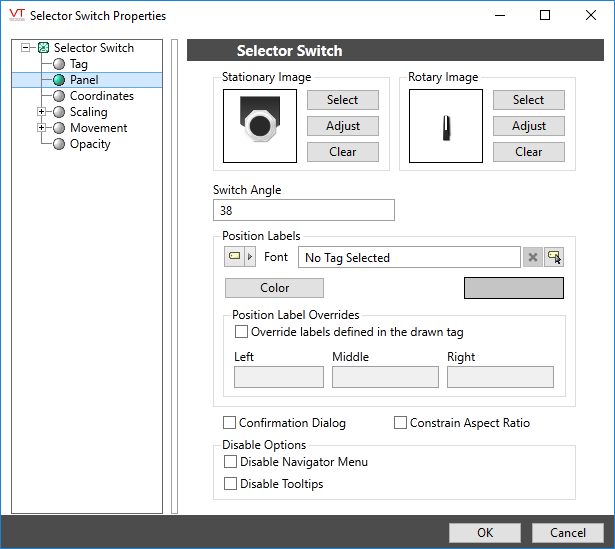

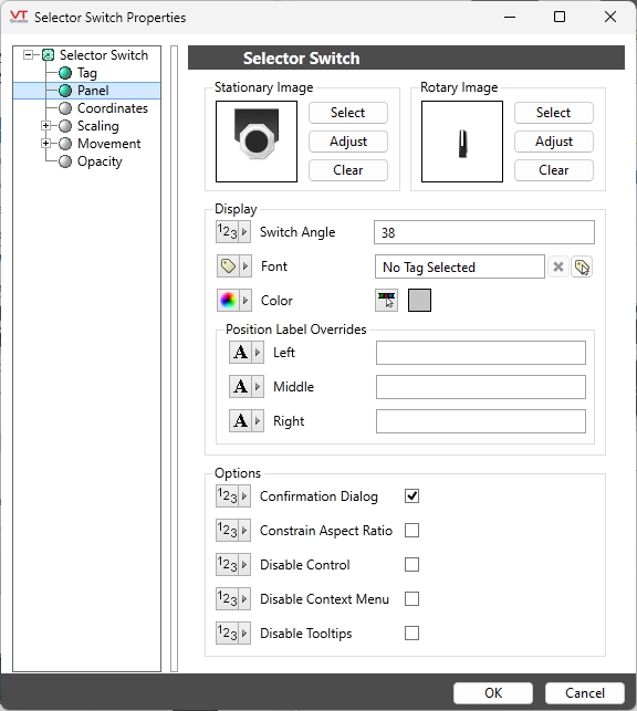

Stationary Image
Any image may be chosen for the base image, but three in particular are provided in the Selector Switches folder: Plate1a, Plate1a-Large and Plate1b. (See example at the beginning of this topic). The base image provides a background for the switch and the labels.
Image Select
Opens the Select Image dialog, within which you can browse for images, import new images, and select the image to use.
* VTScada recognizes the following image formats: .BMP, .CUT, .PCX, .EMF, .WMF, .JPG, .PNG, .TIF
Image Adjust
Opens the Adjust Image dialog box, which can be used to change the color and other display characteristics of the image. See: Adjust Image Dialog
Image Clear
Remove the selected image and do not select a replacement.
Rotary Image
Any image may be chosen for the switch image. The Selector Switches folder provides three options: Switch1a, Switch1a-Large and Switch1b. This provides a control and indicator knob that will appear on the base image background. Variations of the image shown above can be found in the Selector Switches group of the images library and you are free to add your own images.
Switch Angle
This is the angle between each consecutive position of the switch. Any value from 0 to 120 may be set. As shown in the following images, an angle that is too small (5 deg, shown on the left) will be difficult to use, while an angle that is larger (120 deg, shown on the right) may cause the labels to display outside the area of the base image.
Font
Select one of the font tags (or parameter linked to a font tag) that you wish to use to display the text. The display will use the default system font if you do not select a font tag.
The parameters button is enabled only if the tag is drawn on a page that includes a font parameter, or if the tag is part of a widget and the associated widget editor is open.
Note: While it is possible (and very easy) to modify the appearance of the text within this widget using the Format ribbon of the Idea Studio, you will find it much easier to manage a group of similar controls by defining a font tag and selecting that for each. Changes to all can then be made by adjusting the properties of a single font tag.
Color
Opens the Select Color Dialog from which you can select the color of the text.
Position Label Overrides
Set labels within the widget configuration that should be used in place of those configured in the linked tag.
Confirmation Dialog check box.
The confirmation dialog check box can be selected if you wish the user to be prompted for confirmation of the new value being set.
Constrain Aspect Ratio.
Prevents the image from being deformed when resized on the screen.
Disable Options
