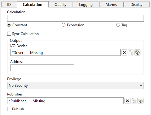

Calculation
For any data type, there is a Calculation option. This counts as a separate but matching mode for each listed in the drop-down. (So, Analog -> Analog Calculation)
Use this when you intend to create an expression that will be set the tag's value (or select another tag that this one should mirror). When creating a calculation, the choice of data type affects the values that can be returned by the expression and the set of widgets that can be used to display that value.
  • Calculation results can be written to an output address, in which case the tag will count towards your tag license.
  • Calculations that do not write to an output address do not count towards your license.
  • Any I/O tag with the Calculation mode set does not count as a memory tag. (Memory Tags)
  • Calculations do not retain their value across restarts. Use a legacy Analog Status (Analog Status Tags) or Digital Status (Digital Status Tags) if that feature is required.
  • In applications that run on multiple workstations, calculations are performed locally on each workstation unless the synchronize option (Sync) is selected. Either mode may be appropriate depending on the purpose of the calculation.

I/O and Calculations tag: Calculation tab
Used for: All Calculation modes
There are three versions of this tab, depending on the data type of the tag. Select the one you are interested in from the following drop-downs.
It is important that the calculation expression match the data type. For example, a digital calculation expression should have a value of 0 or 1. Proper behavior cannot be guaranteed unless the result matches the tag's data type. For example, a text expression for a discrete data type will resolve to an Invalid.
If the Sync Calculation option is not selected, Calculations are performed locally on each machine running the application and are not synchronized between machines.
Calculation
Holds the expression that this tag should calculate. (Expressions) While you can specify a constant or select another tag to mirror it's value, in most cases you will select the Expression option, then click on the button in order to open the expression editor.
In calculation mode, the I/O tag does not retain its value across application restarts. If this is required, use the legacy Analog Control Tags.
Sync Calculation
The default is for calculations to be done on each local machine. If Sync Calculation is selected, the calculation is performed only on the current server and the value broadcast to other machines. "Current server" means the server for the parent driver tag, if there is one. Otherwise, it is the server for the Network Values service.
I/O Device (Optional)
Select the communication driver tag that data will be read from or written to.
By default, the tag will look for a parent tag that is a device driver (*Driver). If none is found, the text "--Missing--" will be displayed. The tag button to the right of the field opens the tag browser, from which you can either select an existing communication driver tag or add a new one. The X button will clear the field. Right-clicking on a tag in the field will open a dialog with which you can add or remove a Snapshot Expression, or open a selected driver's properties dialog.
Address (Optional)
Provide the address within the I/O device to which this tag is to write data. This value must match the configuration of your PLC or RTU hardware. Refer to the Addressing topic for your particular device driver for guidance.
For some drivers (SNMP and the OPC Client) an address browser is provided to assist you.
Deadband (Numeric and Discrete Calculation only. Optional.)
Changes in value smaller than this are not written by the tag.
Expected Range - Min and Max (Numeric and Discrete Calculation only. Optional.)
Used to provide default minimum and maximum values to certain widgets. (The Numeric Calculation type does not have a scaling tab, where these values would otherwise be set.)
Pulse Duration (Digital Calculation only. Optional)
When set to a positive, non-zero number, the tag will a specified signal (1 or 0) to the Write Address, then retain that value for the number of seconds specified by the duration. At the end of that time, the opposite value is sent to the write address and the tag's value returns to its normal state.
An important distinction from the Digital data type is that the calculation tag’s value does not return to its original state once the pulse its done (just the written value). To reset the pulse for a digital calculation, the expression’s value must go to 0 and then back to 1. This means that triggering a pulse repeatedly does not create a single long pulse, as in the normal digital case.
Invert Output (Digital Calculation only. Optional)
If selected, the a calculated state of the tag of 1 write as 0.

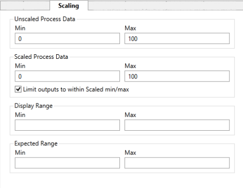

I/O and Calculations tag: Scaling tab
Used for: Analog and Discrete
Only the first four fields affect the value.
I/O scaling illustrated
VTScada assumes a linear relationship between the values as shown. The scaled and unscaled process values you provide set the slope of the line, allowing any value on one axis to be mapped to the other.
The values do not limit what the tag can read, but the Scaled Process Min and Max values do limit what the tag can write.
Min and Max Unscaled Process Data (Required.)
Use these to tell VTScada the range of raw values to expect from or write to hardware.
Min and Max Scaled Process Data (Required.)
Values must correspond to the Unscaled Min and Max values. VTScada uses these to convert between engineering units displayed in the SCADA system and raw values read from or written to hardware.
Display Range Min and Max (Optional.)
These two fields have no effect on the value of the tag.
Set the Min and Max Display Range values to define the default scale range for the HDV trend view and certain widgets, such as the various meters. Use these when values are expected to stay within a portion of the full scale range and it is therefore helpful to adjust the displayed range as needed.
If left blank, the Scaled Process Data Min and Max values will be used as the Display Range values.
Expected Range Min and Max (Optional.)
Used to provide default minimum and maximum values to certain high performance graphics widgets. If left blank, the expected range feature of those widgets is not drawn. Both must be provided.
The expected range is shown in pale blue.
The color is controlled by the assigned Style Settings tag.

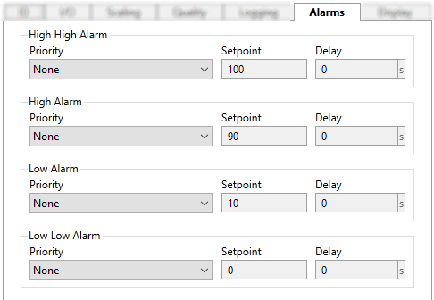

I/O and Calculations tag: Alarms tab (Basic analog type)
Used for: Analog, Discrete, and matching calculation modes
The basic version of this tab allows quick configuration of up to four alarms, two high-level and two low-level.
Unlike the legacy Analog Status tag, you do not need to enable the alarm as well as selecting a priority.
Do not configure an alarm for configurations that write but do not read.
Basic mode of the Alarms tab for analog values
Priority
Use the drop-down tool to select the priority for each alarm that will be triggered by this tag. The available priorities are:
  • None
  • 0 - Event
  • 1 - Critical Alarm
  • 2 - High Alarm
  • 3 - Warning Alarm
  • 4 - Notice Alarm
If you have defined your own Alarm Priority Tags, those will also be available for selection.
Setpoint
Sample setpoints are provided, based on the default scale values of the tag. You must change these to the setpoints at which an alarm should be triggered. To link the setpoint to another tag or an expression, use the Advanced version of this tab.
Delay
To avoid nuisance alarms due to transient spikes in value, set a delay in seconds. The tag's value must reach or pass the setpoint for this length of time before an alarm occurs. To set a deadband on the value, use the Advanced version of this tab.
State (Discrete)
The state for which the alarm will occur.

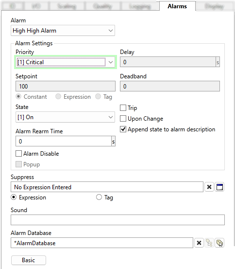

I/O and Calculations tag: Alarms tab (Advanced type)
Content varies. Used for: Analog, Discrete, Digital, 2-bit Digital, and matching calculation modes
For all the following descriptions, assume that for each data type, the matching calculation mode also applies. For example, what applies to Analog also applies to Analog Calculation.
For Analog and Discrete, after switching to the advanced tab, there is no option to switch back to the basic tab. If you use this tab to do any alarm configuration, the basic option will no longer be available. (If you close the properties dialog without doing advanced alarm configuration, then the basic tab will still be available the next time you open the dialog.)
The following figure is a composite of all possible parameters.
         No single version of the advanced Alarms tab includes all the parameters shown here.
A composite of all alarm parameters.
                   >> No single version includes all the parameters shown here <<.
Alarm (Analog, Discrete)
Select any of the four built-in alarms that are available for Analog and Discrete I/O types.
Alarm (Digital, 2-bit Digital)
The only available choice is "State", meaning that alarms are triggered by a change to a defined state value.
Priority (All types)
Use the drop-down tool to select the priority for the selected alarm. This will also enable the alarm.
Delay (All types)
Setpoint (Analog and Discrete)
The value at which the alarm will occur. An expression or tag can be used to create a variable setpoint for Analog or Discrete data types.
State (Digital)
Options include [0] OFF, [1] ON, or [Upon Change]
There is no option (other than a parameter expression) to use an expression or tag for this parameter.
State (2-bit Digital)
Options include [0] OFF, [1] ON, [2], [3] or [Upon Change]
Trip Alarm (Digital, 2-bit Digital)
Select if this alarm is to be a trip alarm. When triggered, a trip alarm is not affected by the changing status of the equipment.
For comparison, a "level alarm" has an active state (the level is at or beyond the trip point) and a normal state (the level has returned to normal operating conditions.) A trip alarm simply trips and does not monitor whether the cause returns to normal operating conditions.
After being tripped, all visible and audible notifications will continue until an operator acknowledges the alarm.
Append State to Alarm Description (Digital, 2-bit Digital)
When selected, VTScada will append the text used for the state of the tag, as taken from the list configured in the tag’s Display tab.
Deadband (Analog and Discrete)
Does not change the setpoint. Use this to avoid nuisance alarms that activate and normalize due to a value that fluctuates into and out of the alarm condition as defined by the type and setpoint. The level must drop (or high alarms) or rise (for low alarms) by this much past the setpoint before the alarm condition is considered to have normalized.
Alarm Rearm Time (All types)
Measured in seconds. If a valid, non-zero value is given then if the alarm has been acknowledged, but remains active for the time shown in this field, the alarm will return to the unacknowledged state. Audible and visible warnings configured for this alarm’s priority level, will again be displayed.
Does not apply if Trip is selected. (Digital types only)
Alarm Disable (All types)
Select to flag the alarm as disabled without changing other configuration. Disabling of alarms is typically used in situations where you wish to avoid false alarms. For example, in the event that routine maintenance is being performed on the equipment represented by this tag, or when you are aware that another interruption in communications will occur for a period of time. In such situations, the alarm can be disabled until the maintenance is complete and communications are reestablished.
Many sites like to tie this property to Digital tag so that many alarms can be disabled at the same time for maintenance. That option is not available with the built-in alarms, but you could use Alarm Tag instead.
Popup (All types)
The application property AlarmPopupsEnable must be set to 1 (Alarms Tab of the Edit Properties Page). If set, a pop-up dialog will be displayed whenever the respective alarm is triggered. This feature should be used sparingly.
Sound (All types)
The Sound field can be set to blank, 0, 1, or to the name of a .WAV sound file to be played.
  • If 0, no sound will be played when this alarm is triggered.
  • If blank or 1, an alarm sound whose properties are configured on the associated Alarm Priority tag will be played.
  • If the name of a .WAV sound file, it will override any alarm sound configured for the associated Alarm Priority tag. If the specified sound file is not found, the alarm will revert to using tones as specified in the associated Alarm Priority tag.
The .WAV file must be stored in the application folder and must be added to the application by using the Import File Changes Tool
Alarm Database
This tag will be linked to the first parent Alarm Database in the tag hierarchy. If none found, it will use the System Alarm Database.
Use this parameter to link the tag to an alternate Alarm Database of your choice.
