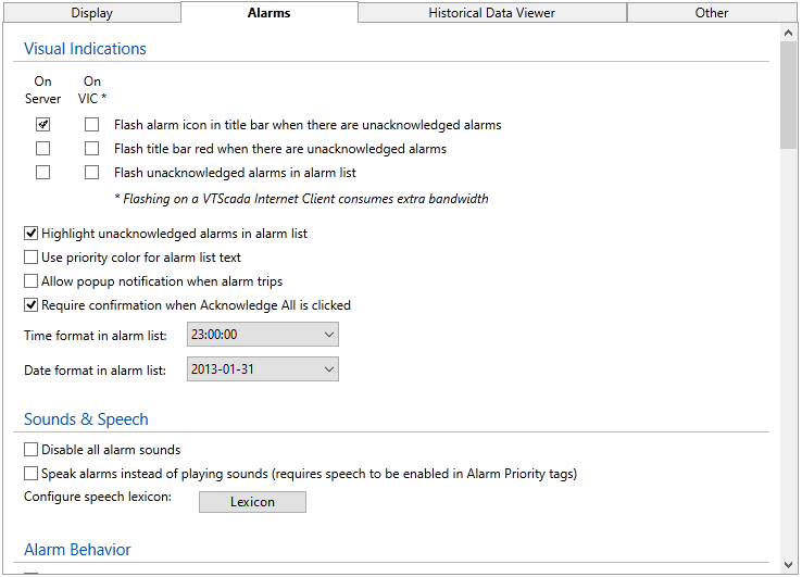

Alarms Tab of the Edit Properties Page
Use the alarms tab of the Edit Properties page to set general appearance and behavior of alarm displays and the VTScada Alarm Notification System.
Visual options set where and whether alarm indicators flash, whether pop-up notifications can be configured, and the time and date display format. You can disable alarm sounds or have the server speak a message instead of using the default tones. Automatic page navigation can be enabled so that a relevant page opens automatically when there is no user-activity for a period of time, and you can choose to require notes to accompany operation actions such as acknowledging or shelving an alarm.
This is also the place to configure the Alarm Notification system, setting which priority of alarms will be sent, delays, notification rules and whether digits should be spoken as operators press the keys on their phone.
If using a mail server for alarm notifications or reports, or Twilio® for alarm notifications, configure the connection parameters here.
| Property | Stored as | Description |
| Flash alarm icon in title bar when there are unacknowledged alarms. |
When selected, the alarm icon in the title bar will flash rather than simply showing red. If your internet connection is limited by bandwidth restrictions, we recommend that you do not enable this option for the VIC display. |
| Flash title bar red when there are unacknowledged alarms |
When selected, the entire title bar will flash red while there are unacknowledged alarms that are visible to the logged-on user. If your internet connection is limited by bandwidth restrictions, we recommend that you do not enable this option for the VIC display. |
| Flash unacknowledged alarms in alarm lists | FlashUnackedAlarmsOnServer
FlashUnackedAlarmsOnVIC |
When selected, unacknowledged alarms in the alarm list will flash, to draw operator attention. Separate options exist for the server and VIC If your internet connection is limited by bandwidth restrictions, we recommend that you do not enable this option for the VIC display. |
| Highlight unacknowledged alarms in alarm list | HighlightUnackedAlarms
When selected, unacknowledged alarms will be shown with a highlight color in alarm lists. |
| Use priority color for alarm list text. | AlarmListUsePriorityTextColor | When selected, text for the alarm in the Alarm Page and Alarm List uses the priority color. Otherwise, white text is used on a dark background, and black when the background is light. |
| Allow pop-up notification when alarm trips | AlarmPopupsEnable | Pop-up alarm notifications must be enabled on an alarm-by-alarm basis, but may not be enable at all unless this option has been selected. |
| Require confirmation when Acknowledge All is clicked | AckAllRequiresConfirmation | Operators must click through a confirmation dialog when attempting to acknowledge all the alarms shown in the list. |
| Time format in alarm list | AlarmDisplayTimeFormat | Choose how time will be shown. |
| Date format in alarm list | AlarmDisplayDateFormat | Choose how dates will be shown. |
