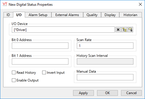

Digital Status properties I/O tab
The I/O tab holds the properties used to identify and establish a connection to the communication driver tag being used to exchange data with your physical I/O device (e.g. PLC or RTU), or to the polling driver responsible for determining the order and rate at which data polls will occur.
Note: Digital Status tags can have single or double bit addresses. Information on single and double bit digital inputs can be found in Single Bit and Double Bit Digital Inputs.
I/O Device
Select the communication driver tag from which data will be read.
By default, the tag will look for a parent tag that is a device driver (*Driver). If none is found, the text "--Missing--" will be displayed. The tag button to the right of the field opens the tag browser, from which you can either select an existing communication driver tag or add a new one. The X button will clear the field. Right-clicking on a tag in the field will open a dialog with which you can add or remove a Snapshot Expression or open a selected driver's properties dialog.
Bit 0 Address
The Bit 0 Address property is the address of the low order bit for this tag in the I/O device. If this is a single bit digital tag, this is the field that specifies the address of that bit. The reported value of this digital tag is the data at this address plus two times the data at the Bit 1.
Address Assist:
Several drivers including SNMP, OPC Client, Fisher ROC and others, provide an Address Assist button to help you. The content of the dialog will vary according to the driver. Within this guide, refer to the Driver Addressing topic for your driver for more information.
Bit 1 Address
The Bit 1 Address property is the address of the high order bit for the digital input in the I/O device. If this is a single bit digital input, this field should be left blank.
If the option, Read History is selected, this will become the History Address.
Scan Rate
Provide the frequency, measured in seconds, at which the I/O device should be scanned for new data. Reduce system load by setting this as high as possible, as appropriate for the equipment being monitored. If the I/O Device is a Polling driver, which provides its own scan interval, then this field will not accept data.
Read History
If checked, the field Bit 1 Address becomes History Address and the field History Scan Interval is enabled.
History Address
If set, then the Bit 0 address becomes optional. This field provides a means of reading values as recorded by a data logger.
If both the Bit 0 address and the history address are provided, then the bit 0 address will be polled for data at the interval set by the Scan Rate, but the values read from the data logger will overwrite the values logged by this tag when it is updated.
The form for the history address will depend on the RTU. Please refer to the addressing reference chapter for your driver.
You may enter compound address in the History Address field using a parameter expression. For example, if HistAddr and HistoryRate are both properties of a parent tag, the following expression in the History Address field will create a compound address with both components:
Concat("):(" , ..\HistAddr , "):(" , ..\HistoryRate )
The characters "):(" separate each component of the address. Do not add a leading or trailing parenthesis around the entire expression.
Sets the time between polls of the history data logger. If a History address has been set, but this field is left blank, then it will default to the value set in the Scan Rate field. The recommended value for this field is 60 seconds. Lesser values may cause communications to slow down.
Note that it is not possible to enter a parameter expression directly in the History Scan Interval field.
Manual Data
Optionally provide a constant value that will be used instead of input read by the communication driver. It is commonly used when testing a new tag when application is not attached to a live data source. Tags that are using manual data are marked on screen by a flashing exclamation mark.
Off Text
Optionally configure text that will be displayed in some of the tag's widgets when the value of this tag is 0 or false / off.
On Text
Optionally configure text that will be displayed in some of the tag's widgets when the value of the tag is 1 or true / on.
Invert Input
If the Invert Input check box is selected, the value of the tag being used as the data source is reversed (i.e. a 1 becomes a 0 or a 0 becomes a 1).
Enable Output
If checked, this input tag may also be used to write data to the specified Bit 0 address of the communication driver. Pulsed writes are not available. A Security Privilege may be set in the Quality tab to restrict access to this feature.

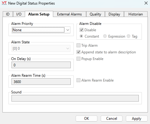

Digital Status properties Alarm Setup tab
Optionally configure one alarm based on the status of this tag. Note that while the priority is set to "None" all other controls are disabled.
Alarm Priority
Select the priority of the alarm that will be triggered for this tag. The available priorities are:
- None (all other controls will be disabled)
- 0 - Event
- 1 - Critical Alarm
- 2 - High Alarm
- 3 - Warning Alarm
- 4 - Notice Alarm
If you have defined your own Alarm Priority tags, those will also be available for selection.
Alarm State
Select the trigger for the alarm. The alarm will be triggered when the tag's state becomes one of the following:
0 The alarm is triggered when Bit 0 goes low. The Bit 1 address either has not been provided or is low.
1 The alarm is triggered when Bit 0 goes high. The Bit 1 address either has not been provided or is low.
2 Two addresses provided. Bit 0 goes low and Bit 1 goes high.
3 Two addresses provided. Both Bit 0 and Bit 1 go high.
Upon Change - any change of state triggers an alarm. Note that when the Upon Change option is selected, the trip alarm option will be set and cannot be deselected by the developer.
Alarm Delay
Transient changes in state can result in multiple alarms being triggered. By setting an alarm delay, you can specify that if the tag’s state changes back one which does not constitute an alarm situation, it must remain in that state for a given length of time before the alarm is deemed to be inactive.
Alarm Rearm Time
Applies only if Alarm Rearm Enable is selected for this alarm. If the alarm has been acknowledged, but remains active for the time shown in this field, the alarm will return to the unacknowledged state. Audible and visible warnings configured for this alarm’s priority level, will again be displayed. The Alarm Rearm Time is measured in seconds, and defaults to 3600 (1 hour). The value in this field must be greater than 0.
Alarm Rearm Enable
Controls whether this alarm will revert back to an unacknowledged state if it remains active for the length of time set in Alarm Rearm Time, after having been acknowledged by the operator.
Disable Alarm
Specify whether the alarm for this tag is disabled or enabled. Disabling of alarms is typically used in situations where you wish to avoid false alarms. For example, in the event that routine maintenance is being performed on the equipment represented by this tag, or when you are aware that another interruption in communications will occur for a period of time. In such situations, the alarm can be disabled until the maintenance is complete and communications are re-established.
May be linked to a tag or expression for suppression by design.
Trip Alarm
Select if this alarm is to be a trip alarm.
Trip alarms do not have the attribute of being Active or Inactive based on the value of the Trigger tag. After being triggered, the alarm must be acknowledged by an operator, but the underlying cause of the alarm need not be cleared.
Append State to Alarm Description
When selected, VTScada will append the text used for the state of the tag, as taken from the Off Text and On Text fields in the tag’s I/O tab, to the alarm message.
Pop-up Enable
If the configuration variable AlarmPopupsEnable is set to 1, then setting either the Low Alarm Pop-up Enable or the High Alarm Pop-up Enable, will result in a pop-up dialog being displayed whenever the respective alarm is triggered. It is strongly suggested that this feature be used sparingly.

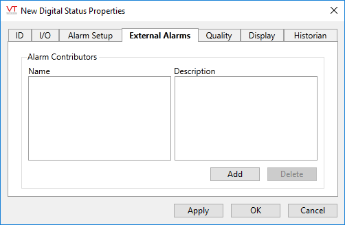

Digital Status properties External Alarms tab
The External Alarms tab is used to display, add or remove separate Alarm tags that are triggered by this Digital Status tag. Use the Add button to create new external Alarm tags and the Delete button to remove them. The new alarm tags will be created as children of the current tag.

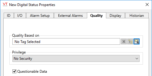

Digital Status properties Quality tab
The Quality Based On field can be tied to a driver tag, a tag that monitors driver communication errors, a register in the PLC or RTU, or any other indication of system health. The tag you are configuring will use that value to set an internal variable named QualityIssue. You may test this value in an expression: [TagName]\QualityIssue.
QualityIssue will be a 0 or 1. "Good Quality" is defined as a value of "0 or Invalid" and "Bad Quality" is defined as any valid, non-zero value. This is consistent with driver communication error values.
Widgets that use the System Style tag will display bad quality using the color set on the Exceptions tab.
The Quality Based On field can also be used when this tag is to be a contributor to a custom-built container tag. Please see the topic Merit tab and Quality tab, for details.

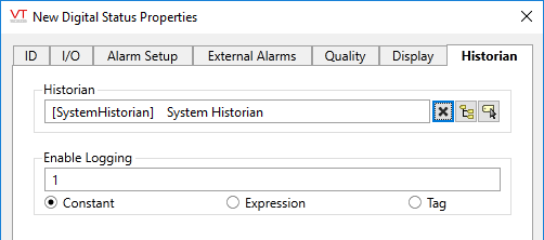

Digital Status properties Historian tab
Historian
There are consequences if you change the selected Historian tag after you have begun collecting data. If you switch to a new Historian (perhaps for organizational or load sharing purposes), the data collected for this tag by the previous Historian will become inaccessible. Historian selection and configuration should be done during the project design stage.
Enable Logging
If values should be logged only while certain conditions are true, you can tie the Enable Logging option to any tag or expression that will change from zero (logging disabled) to non-zero (usually 1; logging enabled).
