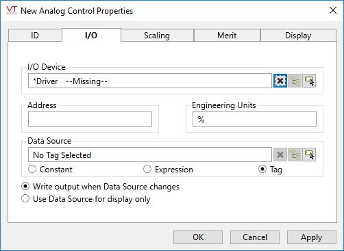

In the I/O tab, you will find the properties used to identify and establish a connection to the communication driver tag being used to exchange data with your physical I/O device (e.g. PLC or RTU), or to the polling driver responsible for determining the order and rate at which data polls will occur.
I/O Device
Select the communication driver tag from which data will be read.
By default, the tag will look for a parent tag that is a device driver (*Driver). If none is found, the text "--Missing--" will be displayed. The tag button to the right of the field opens the tag browser, from which you can either select an existing communication driver tag or add a new one. The X button will clear the field. Right-clicking on a tag in the field will open a dialog with which you can add or remove a Snapshot Expression or open a selected driver's properties dialog.
Address
Provide the address within the I/O device to which this tag is to write data. This value must match the configuration of your PLC or RTU hardware. Refer to the Addressing topic for your particular device driver for guidance.
For some drivers (SNMP and the OPC Client) an address browser is provided to assist you.
Engineering Units
Provide units of measure that the input data represents. Possible values for this field include "rpm" "degrees C", "%", etc
Data Source
[Optional] While Analog Control tags usually take their value from an operator-controlled drawing object, the Data Source field provides the option of configuring this tag to accept a value from another tag or expression instead.
The value from the Data Source can be written to the I/O device, or it can be used to simply update the widget display.
If you have selected a data source that is configured to write output and have also drawn the tag as an object that operators can use to set values, then both can write to the I/O device. The value written will be whichever was most recently changed.
Write output when Data Source changes
When selected, the value supplied by the data source tag or expression will be written to the I/O device and will also be used to set this tag’s value. Selecting this option automatically deselects the "Use Data Source for display only" option.
When selected, the value supplied by the data source tag or expression will not be written to the I/O device but will be used to set this tag’s value. Selecting this option automatically deselects the "Write output when Data Source changes" option.

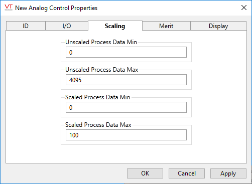

Analog Control properties Scaling tab
The Scaling tab is used to convert scaled data (intelligible to operators) into unscaled, raw data for the I/O device. VTScada uses an algorithm to calculate this tag's value internally, based on the known unscaled and scaled values you supply.
The default value for each of these fields is stored in an application property. You are advised to change those properties to match the values used by your hardware by using the Edit Properties page of the Application Configuration dialog.
You will need to use the Advanced mode of the properties page. The properties to copy and edit are:
- AnalogUnscaledMinDefault
- AnalogUnscaledMaxDefault
- AnalogScaledMinDefault
- AnalogScaledMaxDefault
VTScada assumes a linear relationship between the values as shown. The scaled and unscaled process values you provide set the slope of the line, allowing any value on one axis to be mapped to the other. The values do not limit what the tag can read, but the Scaled Process Min and Max values do limit what the tag can write. |

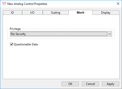

Analog Control properties Merit tab
Privilege
