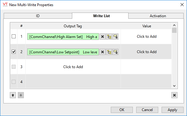

MultiWrite properties Write List tab
The Write List displays the output or memory tags that will be written to, and controls what value will be written to each. The outputs will be written in the order in which they are displayed.
You can add or edit any tag in the list by clicking on a row. You must select a tag before configuring the value to be written to it.
The Tag and Value input fields will be activated when a row is selected, except that rows must be filled in sequence from #1. You cannot add a tag to row three before row two has been completed.
The grid displays the name and description of each tag selected to be written to. The Value column shows what will be written to each tag when the MultiWrite is triggered. The value may be any of a constant, an expression or another tag’s value. In the case where another tag’s value is to be written, that tag’s name will be display in the Value column.
Note that, the display may show a tag's Unique ID rather than its name when the tag is not selected. The description will always be shown for every tag, to help avoid confusion.
To add a tag to the list, select the next available row, then click on the Tag Browser button. Select or create an output tag. After you have specified the tag to write to, you can provide a value to write using the Value field.
To remove a tag from the list, select its row, then click on the X button in the lower-right corner of the window.
The arrow buttons below the grid may be used to move a selected row up or down in the list, thus controlling the order in which output tags are written to.

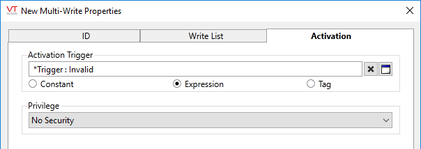

MultiWrite properties Activation tab
The Activation tab provides a way for MultiWrite tags to be controlled automatically. Any tag or expression that will change from a false to a true value can be used to trigger the write.
Privilege
Select a custom security privilege
