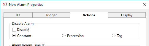

You can also use the tag's configuration panel. This provides more options in an Alarm tag than for a built-in alarm.
Alarm tag - Actions tab.
Note that either an expression or another tag can be used to disable the alarm
