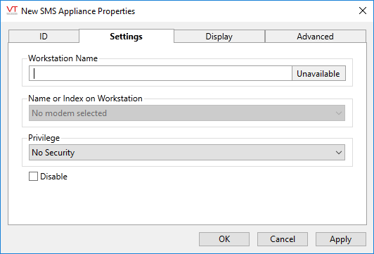

SMS Appliance properties Settings tab
The Settings tab is used to identify the SMS appliance (SMS "modem") that will be used to send and receive messages.
Workstation Name
The name of the computer running the VTScada application, to which the SMS appliance is attached. Workstation names must be no longer than 15 characters. Do not leave blank.
Name or Index on Workstation
The named workstation will be checked for devices. If more than one is found, you may select between them using this drop-down list. Names are preferred over index values, because the latter may change.
Privilege
In this case, "operation" refers to the ability to disable or enable the tag via the context menu. It does not affect whether SMS messages are sent while a user without the privilege is logged on.
Disable
Select this box to disable the device without removing it or deleting its configuration.

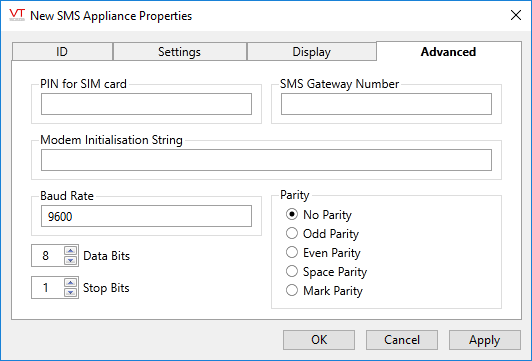

SMS Appliance properties Advanced tab
The fields in the Advanced tab are optional. These need not be set for most configurations and should be used only by developers who are familiar with the configuration of SMS devices.
In rare instances, a device might not use a standard configuration of 9600 baud, etc. Serial port configuration fields are provided for use when working with such a device.
PIN for SIM Card
If required, this will value will be assigned to you by your cellular provider. The password is preconfigured in most SIM cards.
SMS Gateway Number
If required, this number will be provided by your cellular provider. This number is preconfigured in most SIM cards.
Modem Initialization String
You may provide an initialization string, as specified in the user manual for your cell modem. This will be sent to the cell modem at the beginning of each initialization cycle.
In most cases, you do not need to provide this string to the tag.
Baud Rate
Change this field only if your device does not autobaud to 9600.
Data Bits, Stop Bits and Parity
If your device does not autobaud to 9600, you might also need to configure these other serial communication parameters.
