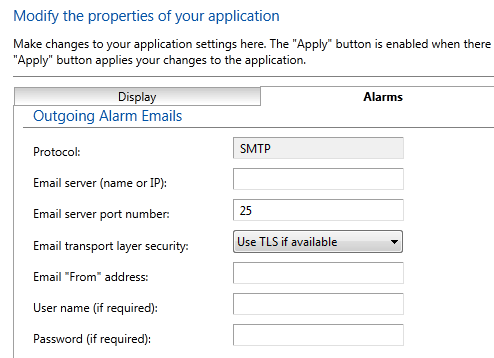

Outbound Email Configuration
VTScada is not an email server. Ensure that you have access to an email server before configuring outbound email options.
- Protocol: Only the SMTP protocol is allowed, therefore there is nothing to configure for this field.
- Enter the name or IP address of the email server.
Typically, this will take the form: "mail.yourcompany.com" or "smtp.provider.com" for an internal email server. - Enter the port to use on your email server.
Typically, 25 for local email servers and 587 if using Transport Layer Security. - Select whether to use Transport Layer Security (TLS).
A connection that does not use TLS is not safe. Consider another provider if your email server does not insist on a TLS connection. - Provide a "From Address" that will be attached to your messages.
Note that some email servers will check that this is a valid email address and will reject the message if it is not.
If you are configuring for alarm acknowledgment by email, this field must include the email mailbox address configured in the Inbound Email tab of the dialog.
Multiple addresses may be used, separated by semi-colons.
In the case of alarm acknowledgment by email, the other addresses will be each receive a copy of the acknowledgment. - Provide the username and password required by the email server for authentication.
These are not your VTScada security credentials. The values you entered will be stored in an encrypted form for your security.

Refer to the Alarm History. If VTScada encounters an error while attempting to send an email, a report will be generated and saved to the alarm history. - No errors reported, but emails are still not arriving.
Check the spam rules on the receiving end. An aggressive filter may be sending your alarm or report notifications to the junk-mail folder.

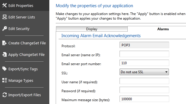

To accept alarm acknowledgments by email, configure the inbound email section after correctly configuring the outbound email section.
Alarms can be acknowledged by email, only in response to an alarm notification email sent from the application which will contain a unique code. The field, Email From Address must match the account on your mail server that this page is configured to access. If any part is left blank, there will be no attempt to receive emails. If incorrectly configured, an event notification (visible in the alarm history) will be generated for every failed attempt to access the server.
- Protocol: Only the POP3 protocol is allowed, therefore there is nothing to configure for this field.
Typically takes the form: "pop.provider.com". - Configure the port number to access on the email server.
Unsecured servers often use 110. Secured ports often use 995. Check with your provider. - Select whether the connection should be made using a secure socket link.
A secured connection is strongly recommended. - Enter the username and password, required to access the account on the POP3 server.
- Adjust the maximum message size if required.
The maximum message size is measured in bytes. This is a safety feature, preventing large incoming messages from slowing the system. Messages larger than the defined size will be deleted from the server rather than downloaded.

- Operators send the alarm acknowledgment email back, but the alarm is not acknowledged.
Ensure that their roster entry includes their current security account name for VTScada. An acknowledgment code is attached to emails only when the roster identifies the receiver's account name.
