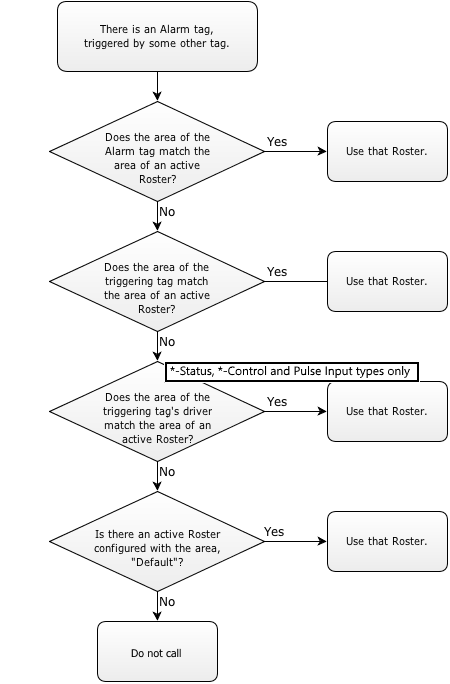

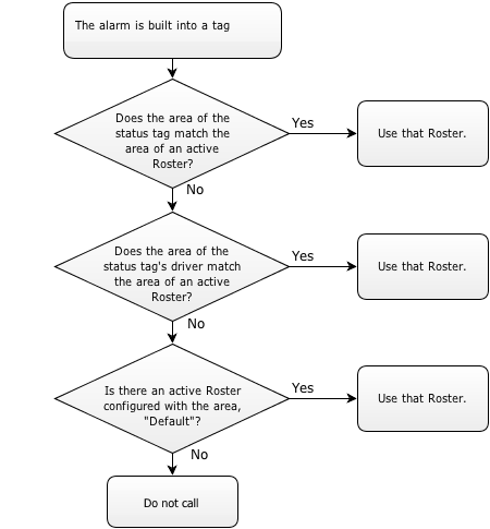

The rules are slightly different for alarms built into tags other than Alarm, and those for tags of type, Alarm.
Alarms built into I/O tags:
 Alarm tags:
