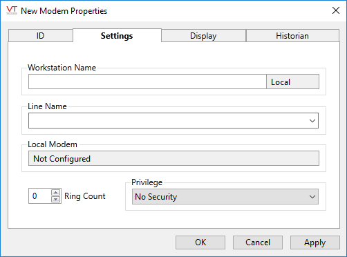

All fields are in this tab are mandatory.
The Settings tab of the Modem tag properties folder contains properties that allow you to configure the network and security settings for the Modem tag. A message is provided to the right of the workstation name, provides extra information about the station's availability, as follows:
If the Workstation field is left blank, the modem tag is for a so-called, local modem, and the text "Local" will be displayed in the workstation message field. This configuration is not recommended - it is much better to specify the workstation name even if VTScada is running only on a single workstation where the modem also resides. (The term "Local Modem" does not mean simply that the modem is on the same machine.) The "Index" parameter (the modem name) for the modem tag is ignored if this modem tag is for a local modem. Local modems are specified by a configuration setting in the <workstation>.Startup file for each workstation as follows:
<Modem tag name>Device = <Modem friendly name>
For example:
Modem1Device = MultiTech Systems MT9234ZPX-UPCI [Trihedral]
If this setting is not provided, the modem manager will select a modem from the list of modems not already associated with a modem tag. (Results may be unexpected.)
Local modems are typically used only if PPP is being used by VTScada, or in a system with custom software designed to use local modems. Under typical operating conditions, Trihedral recommends that local modems NOT be used.
The text, "Available" or "Unavailable" in the workstation message field refers to the workstation's availability. It is displayed even if no modem has been selected.
Workstation Name
Specify the name of the computer to which the modem is connected. If you do not specify a workstation in the Workstation Name field, VTScada will use a local modem on a machine that is running that tag within the application, selecting the first modem that is available.
After the workstation name has been specified, the Line Name and Name Or Index On Workstation drop-down lists will automatically update to display the names of the Serial Port tags and modems available on this workstation.
The workstation name configured in the Modem tag must be no longer than 15 characters.
Line Name
Select or create a name. The same line name must be used by modems sharing the same physical phone line, even if they are on different workstations. Names must be different from those used by modems on other physical phone lines.
The Name Or Index On Workstation drop-down list enables you to select a modem on the workstation specified in the Workstation Name field, provided that the workstation is available. If the specified workstation is not available, you may enter the name of the modem you wish to use, or can enter a number or text value as follows:
If this value is numeric, it is the index into the list of modems shown in the Modems Properties dialog box in the Windows Control Panel, starting from 1.
If the value of Index is a text string, it is the name of the modem exactly as it appears in the Modems Properties dialog that is accessed using the Windows Control Panel.
Because the index of available modems can change over time, it is recommended that you refer to the modem by name rather than by its index in the Modem Properties dialog box.
Ring Count
Select the number of rings you wish to occur before the selected modem answers an incoming call.
If the value of Ring Count is 0, the modem will not answer any calls.
Regardless of this setting, the modem will not be answered if the application property, AnswerCalls is set to 0. Information on this and other configuration variables pertaining to the Modem Manager can be found Application Properties for the Modem Manager.)
Security Privilege
In this case, "operation" refers to the ability to disable or enable the tag via the context menu. It does not affect whether the modem will operate while a user without the privilege is logged on.

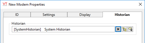

Modem properties Historian tab
Historian
There are consequences if you change the selected Historian tag after you have begun collecting data. If you switch to a new Historian (perhaps for organizational or load sharing purposes), the data collected for this tag by the previous Historian will become inaccessible. Historian selection and configuration should be done during the project design stage.
