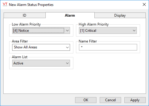

Alarm Status properties Alarm tab
The alarm tab is used to define which alarms will be counted an instance of the Alarm Status tag. Use the fields to select the characteristics that must be found in an alarm to be included in the count.
Low Alarm Priority
Select the lower end of the range of alarm priorities to be filtered for. Any alarm with a priority between the Low Alarm Priority and the High Alarm Priority, and matching the remaining conditions will be included in the filter. The minimum priority cannot be set above the maximum priority.
To filter for alarms of only a given priority, set both the Low Alarm Priority and the High Alarm Priority to that value.
High Alarm Priority
Select the upper end of the range of alarm priorities to be filtered for. Any alarm with a priority between the Low Alarm Priority and the High Alarm Priority, and matching the remaining conditions will be included in the filter. The maximum priority cannot be set below the minimum priority.
Area Filter
Select the area that the alarm must be configured within to be included in the filter. Areas shown in the list include all system alarm areas as well as developer-created areas.
Name Filter
Use this field to restrict the list of filtered alarms to only those matching a given name. The * wildcard may be used to permit selection on a set of similar names. For example, "East*" will match "East Pump Alarm", "East Tank Alarm", etc.
Alarm List
Options include "Active", "Unacknowledged" and "Current". Only one option may be chosen. Restricts the filter to only those matching a particular list type.
