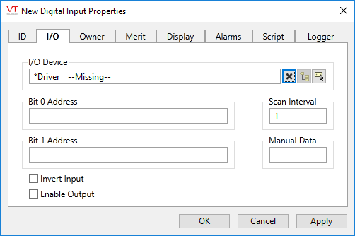

The I/O tab holds the properties used to identify and establish a connection to the communication driver tag being used to exchange data with your physical I/O device (e.g. PLC or RTU). This is done by identifying the communication driver tag that communicates with the physical I/O device, the address at the physical I/O device from which this tag is to read its data, and the rate at which the I/O device should be scanned for data.
I/O Device
Select the communication driver tag from which data will be read.
By default, the tag will look for a parent tag that is a device driver (*Driver). If none is found, the text "--Missing--" will be displayed. The tag button to the right of the field opens the tag browser, from which you can either select an existing communication driver tag or add a new one. The X button will clear the field. Right-clicking on a tag in the field will open a dialog with which you can add or remove a Snapshot Expression or open a selected driver's properties dialog.
Bit 0 Address
The Bit 0 Address property is the address of the low order bit for this tag in the I/O device. If this is a single bit digital tag, this is the field that specifies the address of that bit.
Address Assist:
Several drivers including SNMP, OPC Client, Fisher ROC and others, provide an Address Assist button to help you. The content of the dialog will vary according to the driver. Within this guide, refer to the Driver Addressing topic for your driver for more information.
Bit 1 Address
The Bit 1 Address property is the address of the high order bit for the digital input in the I/O device. If this is a single bit digital input, this field should be left blank.
Scan Interval
Provide the frequency, measured in seconds, at which the I/O device should be scanned for new data. Reduce system load by setting this as high as possible, as appropriate for the equipment being monitored. If the I/O Device is a Polling driver, which provides its own scan interval, then this field will not accept data.
Manual Data
Sets a constant value that will be used instead of live data. Use when testing a new tag if you need to check behavior when a value is outside the normal operating range. Tags that have manual data are marked by a flashing exclamation mark within any linked widgets. Logged values are marked with an exclamation. Always reset this to blank after testing.
Invert Input
The Invert Input check box enables you to specify whether the value of this tag should be reversed. If selected, the value for this tag will be inverted (i.e. 0 and 1 are swapped).
The typical use for input inversion is in projects where 1 indicates false or off, and 0 indicates true or on. By default, the Invert Input check box is not selected.
Enable Output
If selected, this input tag may also be used to write data to the specified Bit 0 address of the communication driver. Pulsed writes are not available. A Security Privilege may be set in the Merit tab to restrict access to this feature.

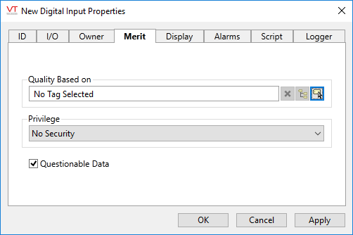

Digital Input properties Merit tab
The Quality Based On field is for use when this tag is to be a contributor to a custom-built container tag. Please see the topic Merit tab and Quality tab, for details.
