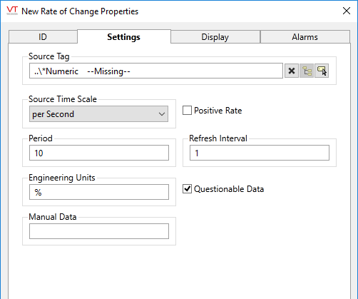

Rate of Change properties Settings tab
The Settings tab is used to select which tag is to be watched and how often it is to be checked.
Source
Use this option to select the tag to be monitored for changes in value.
If you would like to monitor the rate of change of some combination of tags or a calculated value, you should create a Calculation tag with the expression you need and use it as the source.
Source Time Scale
Sets the measurement rate for the change. Available options include: per Second, per Minute and per Hour. For example...
| Source | Source Time Scale | Rate of Change Expressed in: |
| Level (inches) | Hours | inches/hour |
| Pressure (psi) | Minutes | psi/min |
| Flow (liters/second) | Seconds | l/s/s |
Positive Rate
When selected, the absolute value of the rate of change will be shown. Otherwise, a decreasing value in the source tag will be displayed as a negative rate of change.

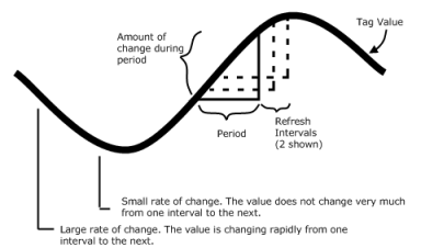

Refresh Interval and Period
- The Refresh Interval sets how often the rate of change is calculated. This value is always measured in seconds.
- The Period defines the length of time over which the change is to be measured. It is also measured in seconds.
The rate of change is roughly defined as the amount by which the value has changed during a given period, divided by the length of time in the period. To state it more accurately, the rate of change is the calculated derivative (dy/dx) of the plotted value.
The rate of change calculation is affected by data noise and transient spikes. The period should always be set to a value larger than the frequency of data noise. To avoid alarms due to transient noise, set a delay on the alarm. (see: Rate of Change properties Alarms tab.)
Engineering Units
Used by various widgets. Set this field to display the units of the rate of change.
Questionable Data
Use this field to flag the tag’s data in the event that you suspect the values it is reporting might not be correct, or when this tag has initially been created and you wish to ensure that its data is marked for extra monitoring.
Manual Data
Sets a constant value that will be used instead of live data. Use when testing a new tag if you need to check behavior when a value is outside the normal operating range. Tags that have manual data are marked by a flashing exclamation mark within any linked widgets. Logged values are marked with an exclamation. Always reset this to blank after testing.

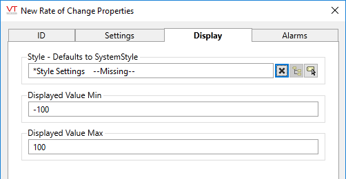

Rate of Change properties: Display tab
The controls in the display tab are used only in connection with the Historical Data Viewer (HDV). The Displayed Value Minimum and Maximum set the initial limits of the y-axis for this tag when it is viewed in the HDV.
These fields do not scale the data.

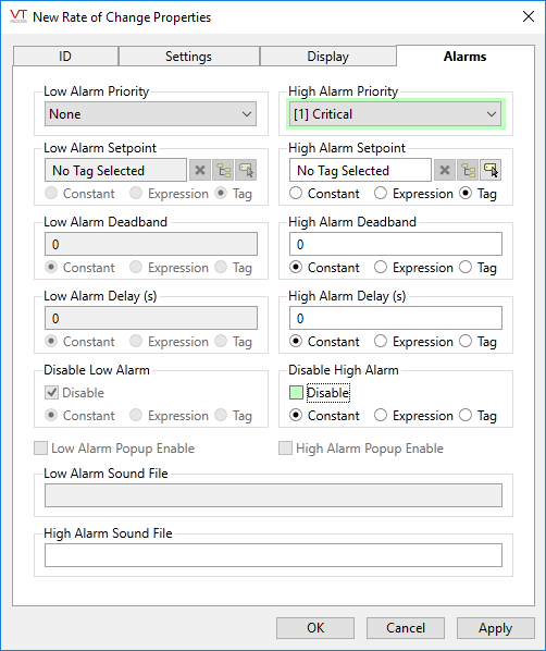

You can set alarms to notify operators when the rate of change is either too slow or too fast.
High alarms are triggered when the rate matches or exceeds a set point. Depending on whether the Positive Rate option is selected on the Settings tab, the Low Alarm can be used either to warn on large negative changes, or to warn when the rate of change falls below a desired minimum.
Low and High Alarm Priority
The Low and High Alarm Priority drop-down lists are used to select the priority of the alarms that will be triggered for this tag. The default priority is None, indicating that neither alarm has been configured. The available priorities are:
- None
- 0 - Event
- 1 - Critical Alarm
- 2 - High Alarm
- 3 - Warning Alarm
- 4 - Notice Alarm
If you have defined your own Alarm Priority tags, those will also be available for selection.
Low and High Alarm Setpoints
Use the Low Alarm Setpoint field to enter the lowest value that this rate of change value will be permitted to attain, after which a low alarm will be triggered. Correspondingly, the High Alarm Setpoint is used to set a value at which the high alarm should be triggered.
If the Positive Rate option is selected on the Settings tab, all rates of change will be positive. In this situation, the high alarm is used to warn of excessively high rates of change (whether the changing value is rising or falling). The low alarm could be used to warn of change rates that are too slow.
If the Positive Rate option is not selected, the high alarm will warn only of excessive change rates for values that are rising. The low alarm set point should be set to a negative value to warn of excessive change rates for values that are falling.
The source for these fields may be either a constant, the result of an expression, or the value of a tag. Please see the topic: Constant, Expression or Tag for more information on selecting between these three choices.
Low and High Alarm Deadbands
If noise in the system causes a value to fluctuate above and below the set point, the alarm will repeatedly switch between active and inactive status. By using the deadband, you can dampen out these fluctuations by setting an amount by which the tag’s value must retreat back past the set point before the alarm state is considered to no longer be active.
For the low alarm, this means that the value must rise <deadband> units above the set point. For the high alarm, the value must fall by <deadband> units below the set point.
The deadband is used only for changing a current alarm’s active status. It does not affect the set point.
Low and High Alarm Delays
Noise in the value being monitored may cause transient spikes or drops in the reported rate of change. To avoid having alarms triggered by system noise, you can set a delay in seconds. The value must meet or exceed the alarm set point for the length of the delay time before an alarm will be activated.
Disable Low or High Alarm
The Disable … Alarm field is used to specify whether either the low alarm or high alarm for this tag is enabled. Disabling of alarms is typically used in situations where you wish to avoid false alarms. For example, in the event that routine maintenance is being performed on the equipment represented by this tag, the alarm can be disabled until the maintenance is complete and communications are re-established.
The value can be provided via any of a constant, an expression, or a tag, where 0 means "not disabled" and 1 means "disabled.
Please see the topic: Constant, Expression or Tag for help selecting which to use.
Low Alarm Pop-up Enable & High Alarm Pop-up Enable
If the configuration variable AlarmPopupsEnable is set to 1, then setting either the Low Alarm Pop-up Enable or the High Alarm Pop-up Enable, will result in a pop-up dialog being displayed whenever the respective alarm is triggered. It is strongly suggested that this feature be used sparingly.

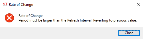

The period must be set to a value that is larger than the refresh interval for the Rate of Change tag to work properly. Attempting to set either value such that this is no longer the case will result in the following error dialog:
Acknowledge the dialog by clicking on the Close button, then adjust the complementary value (either a larger period or a smaller refresh interval) before continuing to set the value you were first attempting to set.
