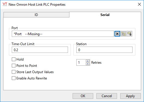

Omron Host Link Driver properties Serial tab
The Serial tab for the Omron Host Link driver tag properties folder consists of attributes used to identify and establish a connection the Serial Port tag that the Omron Host Link driver should use to transmit data to the I/O device. The Serial tab is also used to select the communication protocol to be used in transmissions of data between the I/O device and the driver.
Port
Enables you to select the Serial Port tag or TCP/IP tag you wish to be associated with this driver tag. A Serial Port tag opens a serial port to enable communications between VTScada and your PLC or RTU. A TCP/IP tag enables you to connect to a series of hosts, allowing you to transmit data across a network or over the Internet.
The Port field can be cleared using the X button that appears to its right.
Time-Out Limit
Sets the receiver time-out limit (i.e. the time in seconds or fractions of a second that this driver should wait for a reply from the PLC or RTU).
Hold
Point To Point
Select whether the Point To Point protocol to be used by the Omron Host Link driver in communications with the PLC.
If selected, the driver will use point-to-point protocol (PPP) to communicate with the PLC.
If the Point To Point check box is not selected, the driver will use multi-drop protocol.
By default, the Point To Point check box is not selected.
Station
Enter the PLC station address in this field.
Retries
Store Last Output Values
Enable Auto Rewrite
