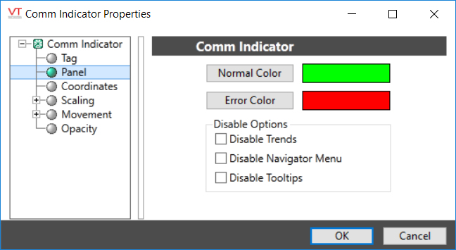

The Comm Indicator tag widget is used to draw an indicator square, the color of which indicates the current status of the associated I/O device.
The properties dialog for the Comm Indicator:
Normal Color
The color to display when the associated I/O device is operating under normal conditions
Error Color
The color to display when the I/O device is in an error state.
