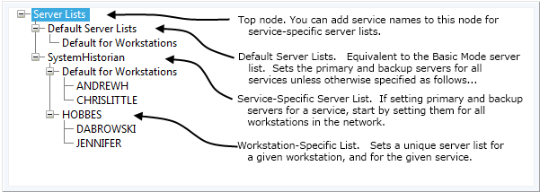

Parts of an advanced server list

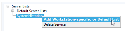

- Right-Click on the service name to open the context menu.
The Add Workstation-specific or Default List dialog opens
- Select the option, "Default for Workstations" and click OK. (1)

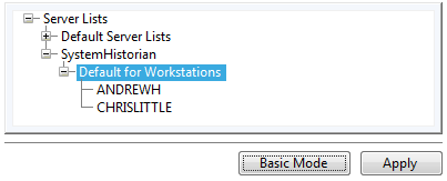

The entry Default for Workstations is added to the tree.

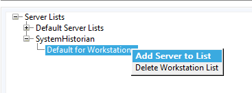

- Right-click on Default for Workstations
- Click on Add Server to List
- Select the computer that is to serve as the Primary Server for this service.
- Click OK
Repeat the last three steps for the backup servers you want to designate for this service.
- Click Apply
(1)It is possible to define a server list that is in effect only for a named workstation.
