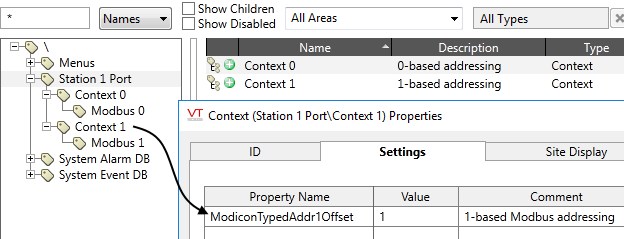

"Type specified" means addresses such as the HC1 and IR2 format. This does not apply to addresses written as numbers only. (For example, 40001 is always the first address in the 40000 block, and is equivalent to HR1 when ModiconTypedAddr1Offset is 0, or HR0 when ModiconTypedAddr1Offset is 1) If you change the property ModiconTypedAddr1Offset, it will be changed for all Modbus-compatible drivers in the application. If you need some drivers to be zero-based and others to be one based, you can achieve this by creating a parent Context tag for each driver, adding a property named ModiconTypedAddr1Offset to that Context tag. The child driver tag will take the value in the parent Context tag instead of the global property value. (See: Context tag properties, Settings tab)

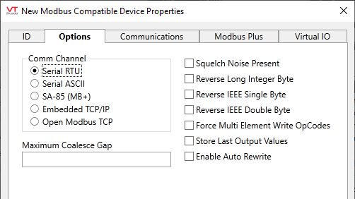

Modbus Compatible Device: Options tab
The Options tab of the Modbus Compatible Device tag properties folder can be used to set byte swapping for long integer, IEEE single or IEEE double bytes. If this driver is communicating over a modem, then the Options tab is also used to indicate that squelch noise should be suppressed, if present.
Comm Channel
Select the communication channel and protocol to use for this Modbus Compatible Device driver. This will be one of:
- Serial RTU Select to use the RTU mode of the Modbus serial communications standard.
 - Serial ASCII Select to use the ASCII mode of the Modbus serial communications standard.
 - SA-85 (MB+) Select to use the Modbus Plus communications protocol via a Modicon SA-85 card.
 - Embedded TCP/IP Select to use the Embedded TCP/IP protocol.
 - Open Modbus TCP Select to use the Modicon Open Modbus/TCP specification to receive Modbus protocol over Ethernet TCP/IP.
Squelch Noise Present
Applies when communicating over a modem. Select this box to enable the squelching of background noise. By default, the Squelch Noise Present check box is not selected.
Reverse Long Integer Byte
Select whether byte swapping should occur for long integer values. By default, the Reverse Long Integer Byte check box is not selected.
Reverse IEEE Single Byte
Select whether byte swapping should occur for IEEE single byte values. By default, the Reverse IEEE Single Byte check box is not selected.
Reverse IEEE Double Byte
Select whether byte swapping should occur for IEEE double byte values. By default, the Reverse IEEE Double Byte check box is not selected.
Force Multi Element Write OpCodes
Certain hardware requires data to be written using multi-element OpCodes (15 and 16) even though the actual data is single-element (OpCodes 5 & 6). By selecting this box, you can ensure that this driver instance is able to communicate with devices that require the multi-element codes.
Store Last Output Values
Enable Auto Rewrite
Maximum Coalesce Gap
Use only if the Modbus compatible device does not support reads from addresses that are not explicitly declared in the device. VTScada will attempt to coalesce reads from a range of addresses, which may lead to an error with these devices.
If left blank, there is no effect on driver coalescing.
Set to zero to allow for devices that cannot read from addresses that are not explicitly declared.
Set to a number greater than zero to fine-tune read coalescing. The gap is measured in units of two-byte words. Warning: when using low maximum coalesce gap values, it is important to avoid unnecessary gaps in VTScada tag addresses.
if this value is set, driver response time may be slowed due to the increased number of read blocks.
See also: VTSMaxBlock

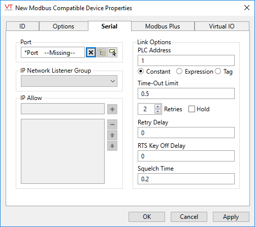

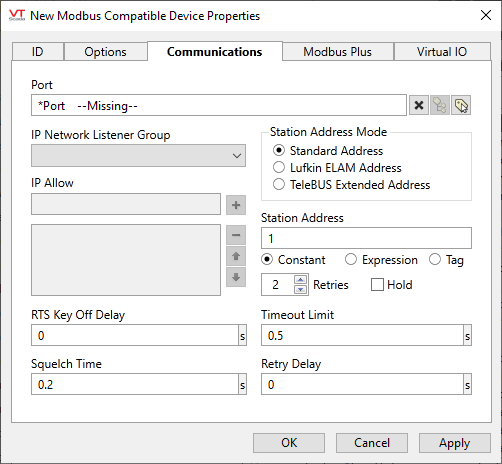

Modbus Compatible Device: Serial tab
The Serial tab for the Modbus Compatible Device Driver tag properties folder consists of attributes used to identify and establish a connection to the hardware.
Port
Enables you to select the Serial Port tag or TCP/IP tag you wish to be associated with this driver tag. A Serial Port tag opens a serial port to enable communications between VTScada and your PLC or RTU. A TCP/IP tag enables you to connect to a series of hosts, allowing you to transmit data across a network or over the Internet.
The Port field can be cleared using the X button that appears to its right.
IP Network Listener Group
Configure only if this driver is to accept in-bound TCP or UDP communications. Select an existing IP Network Listener tag using the drop-down list.
If the IP Network Listener is configured, this driver must use Open Modbus TCP, configured on the Options tab.
IP Allow
Optional. Misconfiguration of this field is a common source of problems.
Used in connection with an IP Network Listener tag. General IP address filtering should be set on the IP Network Listener, as this will be more efficient. The list of allowed IP addresses in the driver is intended to prevent misconfigured devices from interfering with other devices.
Both filters (that in the Network Listener and this one) can be configured at the same time. The filter in the IP Network Listener will be applied when the device first connects and the local filter will be applied after a specific driver instance has been identified.
PLC Address
The station address of the Modicon programmable logic controller. By default, the PLC Address field is set to 1.
An expression may be used to provide the address if needed. This may be required on a network where the address varies depending on the workstation where the tag is running.
Note that, to create a valid expression for an address that contains non-numeric characters, you must enclose the address in quotation marks. e.g. "31.0.0.0" See: Modbus Plus PLC Addressing.
Time-Out Limit
Set the receiver time-out limit in seconds or fractions of a second. This is the length of time that this driver should wait for a reply from the PLC or RTU.
Retries
Retry Delay
The Retry Delay field enables you to specify the amount of time (in seconds or fractions of a second) that the driver will wait between attempts to repeat a transmission of data if the previous attempt(s) have failed.
By default, the Retry Delay field is set to 0 (indicating that there should be no delay between retry attempts).
Hold
RTS Key Off Delay
The RTS Key Off Delay field represents the amount of time (in seconds) that this Modbus Compatible Device will wait before dropping RTS at the end of a data transmission.
Squelch Time
Sets the amount of time (in seconds or in fractions of a second) to wait before clearing noise. Enabled only when Squelch Noise Present has been selected on the Options tab.

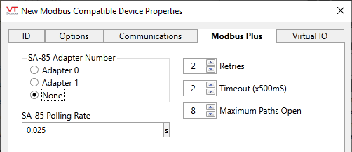

Modbus Compatible Device properties Modbus Plus tab
The Modbus Plus tab of the Modbus Compatible Device tag properties folder is used when an SA-85 I/O card for Modbus Plus communications has been configured.
SA-85 Adapter Number
The SA-85 Adapter Number section enables you to specify the number of the adapter if you have installed an SA-85 network adapter card for Modbus Plus communications networks. You can specify adapter 0, adapter 1, or none by selecting the associated radio button. The default setting for the SA-85 Adapter Number section is None.
SA-85 Polling Rate
Set the rate in seconds or fractions of a second at which you wish the SA-85 network adapter card to be polled. The default SA-85 Polling Rate setting is 0.025.
Retries
Select the number of attempts that will be made by this driver if there is no reply to a message. An error will be declared after this number has been reached.
Time Out (x500mS)
Specify the message response time limit that the driver will wait for a reply from the PLC. This time limit may be set from 1 to 20 increments. The default setting for the spin box is 2 (i.e. two 500 millisecond increments, or 1 second).
Maximum Paths Open
Set the maximum number of Modbus Plus sessions that can be opened simultaneously by the installed SA-85 network adapter. The Maximum Paths Open spin box may be set from 1 to 8. The default setting for the Maximum Paths Open spin box is 8.

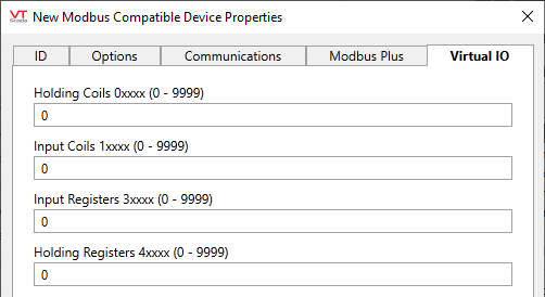

Modbus Compatible Device: Virtual I/O tab
These properties are used to configure a virtual PLC in the memory of your PC. If using virtual addresses, and if your server is connected to the Internet, you may wish to enhance security by adding an IP Network Listener tag. See: IP Network Listener Tags
Holding Coils 0xxxx (0-999)
Enter the number of 00000-series holding coils to be assigned to the virtual PLC.
Input Coils 1xxxx (0-9999)
Enter the number of 10000-series input coils to be assigned to the virtual PLC.
Input Registers 3xxxx (0-9999)
Enter the number of 30000-series input registers to be assigned to the virtual PLC.
Holding Registers 4xxxx (0-9999)
Enter the number of 40000-series holding registers to be assigned to the virtual PLC.
