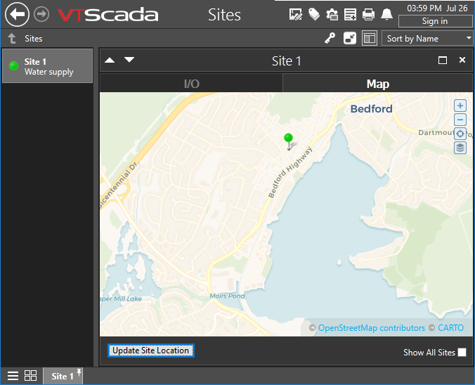

Context tags can be given site parameters, allowing them to be located on a site map. Related configuration parameters allow you to choose the icon that will represent the site and the page that will open when an operator clicks on that site. You can also configure how and whether the site will be shown in the Sites List page.
Other tag types also count as "sites", including Polling Drivers and Station tags.

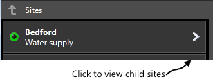

Context tags (and new types created from them) are always included in the Site Display List of a Sites Page. To exclude them entirely (as might be needed for equipment) do the following:
1. Select the Add Site Properties button in the Settings tab of the Context tag.
(See: Change the Parameter List if you have already turned the Context into a new type.)
2. Delete all site properties except for SiteListDisplay.
3. In the Display tab, select the option Exclude from site list

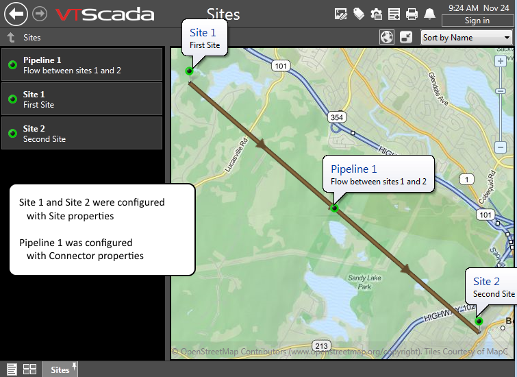

If you have created one or more sites, you can choose to configure another context tag as a connector. Connectors are drawn as a line (you configure the line style) between two sites that have latitude and longitude values. Connectors can have any properties you care to assign and any child tags you want, thus you can use them to represent pipes or transmission lines configured with all the characteristics you require.
Connectors are straight lines between two points. You can create a corner by adding a third site to your map, located between the first and second site, and configuring that intermediate site so that it is not displayed on the map. Add one connector between the first site and the intermediate site, then add a second connector between the intermediate site and the destination site.

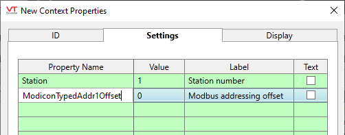

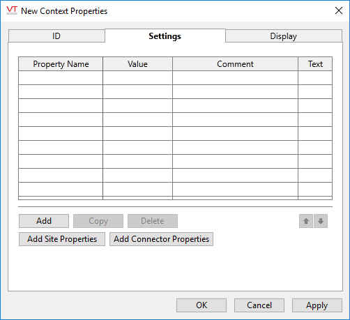

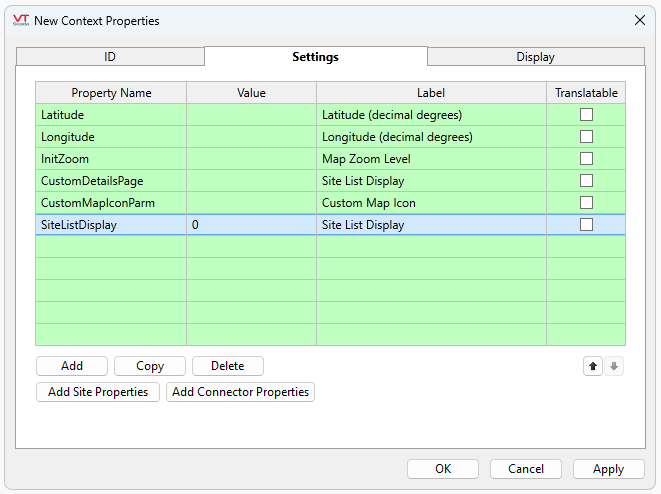

Context tag properties, Settings tab
Context tags may be given a list of named properties. Each copy of the tag may then be given its own unique values for those properties. There is no limit on the number of named properties that you may create.
Property names may not duplicate VTScada reserved words. To be safe, adopt a naming convention that adds a distinct identifier to every name (for example "MA_Name" for My Application...)
By defining properties in a context tag, you provide a method for children of that tag to adapt their configuration values to the parent instance via Parameter Expressions. For example, I/O addresses may be calculated from a BaseAddress value stored in the Context tag instance.
To create a new property click Add, which opens the Add Property dialog:
Property names must be unique, not just in the list of properties, but in the tag itself. VTScada properties such as Name, Area and Description may not be used. Attempting to do so will cause the "Name in Use" dialog to open.
Property names must include letters ("Property2" is valid, but "2" is not). The property name may not include a space or any of the following characters: ! , @ % ^ & * ( ) - ` ~ : ; " ' < > ? / { } [ ] | \ .
You can change any property name, value or comment by clicking on the field in the settings list. Editing is done in-place.

Connectors are not sites, and sites cannot be used as connectors.
Connectors do not have Latitude and Longitude properties. Sites do not have other start and end sites.
To create connectors, you must have both tags configured as sites and tags configured as connectors.

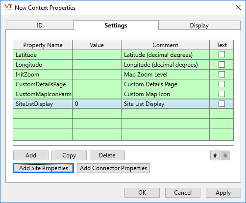

Click this button to add the five properties that relate to site maps, Latitude, Longitude, CustomDetailsPage, CustomMapIconParm and SiteListDisplay. After adding the properties it is easier to assign values for the properties using the Site Display tab. Connector-specific properties will be removed when you add site properties.
- Values for all five can be set using the Site Display tab.
- Latitude and Longitude are required if this context tag is to be added to a site map as a pin.
- SiteListDisplay is necessary if you wish to control whether the tag behaves as a "site" or a "folder" in the Site List page, or should not be shown at all. In the Site List, a "site" will open to a Site Details page when clicked. A "folder" will open within the sites list to show sub-sites (if any) and immediate I/O child tags.
- CustomDetailsPage is required only if you have or will create a custom page to display the child tags of this context tag. Otherwise, you may delete this property and use the standard Site Details page.
- CustomMapIconParm is required only if you intend to create a custom pin to mark this Context tag on a Site Map. Otherwise, you may delete this property and use a standard pin.

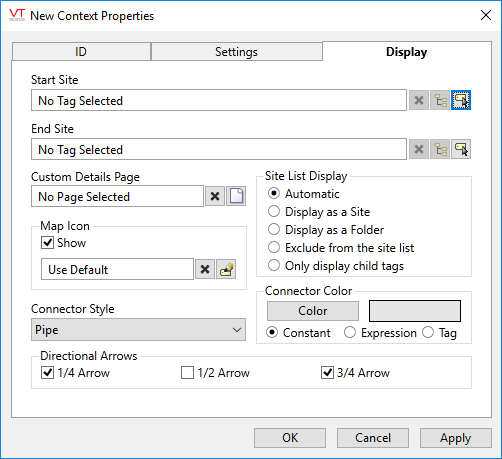

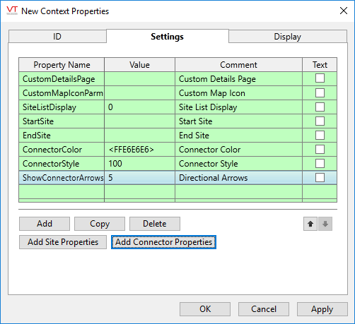

- StartSite and EndSite are required for all connectors. These will be configured with the two tags that hold site properties to mark the latitude and longitude of the start and end of the connector line.
- ConnectorColor defines the color of the line. By default the property is gray, defined using an Alpha value of FF and RGB values of E6E6E6. <FFE6E6E6> You may use any of the numeric values from the VTScada color palette instead.
- ConnectorStyle defines the line type. The drop-down list of the available styles is easier to use than assigning numeric values, which match those provided in the list of VTScada line styles. Note that the line or pipe width cannot be configured as it will scale as the zoom-level changes.
- ShowConnectorArrows defines which of the three possible arrows should be shown in the display. This is stored as a bit-wise value where bit 0 matches the arrow at the 1/4 position on the line, bit 1 matches the arrow at the half-way position and bit 2 matches the arrow at the 3/4 position. Arrows will always point from the start site towards the end site.
- CustomMapIconParm is required only if you intend to create a custom widget to mark this Context tag on a Site Map. Otherwise, you may delete this property and use the standard Site Draw widget.

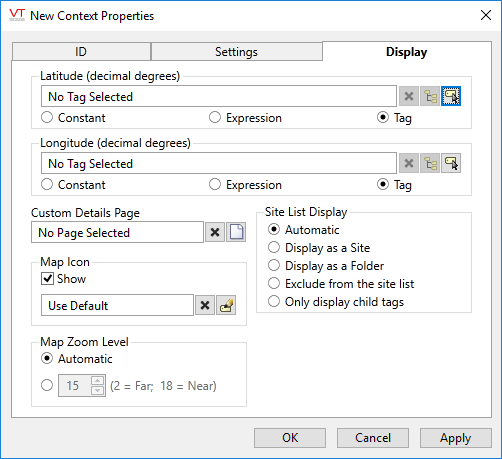

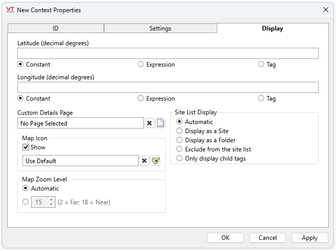

Context properties Site Display tab
Before using this page, you must add either site properties or connector properties in the Settings tab.
(Site Configuration)
(Connector configuration)
There are two ways to prevent a site's location pin from being shown on a map: Leave the Latitude and Longitude values empty, or deselect the Show option for the map icon. If the site has latitude and longitude values, but the icon is not displayed, then the indicator beacon will pulse while the cursor is held over the site's coordinates on the map, even though the pin is not displayed.
Latitude and Longitude (Site configuration only)
Holds location coordinates for this tag, thereby allowing it to be represented on a Site Map page if the map icon is shown.
Start Site and End Site (Connector configuration only)
Holds links to the two site tags, between which the connector will be drawn.
Custom Details Page
If a custom details page has been created for this context tag, then that page should be selected here. If there is no custom details page, then operators will see the standard Site Details page upon clicking the pin for this tag in a Site Map.
Map Icon
You might choose to define a location for this site, but not display it on a map. This is sometimes done to add corners for connector lines or pipes.
If a custom map icon widget has been defined, you can select it here. That icon will then be used instead of the standard icon when this tag is represented on a Site Map page. If there is no custom map icon, then the standard widget will be used. A custom map icon is any tag-widget that can be linked to this tag type.
Assuming that this tag has site properties, it will be included in the list of a Sites page. What will happen when an operator clicks on this tag in that list depends on the Site List display choice, and on whether any of this tag's children are I/O tags. Note that the following applies only to the list section of the Sites page, not to the map.
- Display as Site: A click will open the Site Details page as a pop-up.
- Display as Folder: A click will leave focus on the Sites page, but the list will now show the child tags of this site.
- Exclude from Site List: This tag should not be shown in the list section of the Sites page.
- Only Display Child Tags: This tag is used to group other sites. Those sites should be displayed, but this one should not be displayed. Operators will not need to navigate through this site to reach the child sites.
- Automatic: If this tag contains child sites, folder display will be used. Otherwise, site display will be used.
Connector Style and Color (Connector configuration only)
Choose whether to display the connector as a pipe or as a line using any of the built-in VTScada line styles. The default color will be gray. Use the color option to select any other color.
Map Zoom Level (Site configuration only)
If Automatic is chosen (the default) then when a map is opened, showing only this site, it will zoom to level 15, which shows only the immediate surroundings. You may select any value between 18 (the closest possible level) and 2 (showing the entire globe).
Default zoom level.
Directional Arrows (Connector configuration only)
Up to three arrows can be drawn on the connector, pointing from the first site to the second. These can be added at the 1/4, 1/2 and 3/4 positions of the visible segment of the connector.
