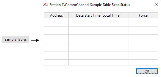

Sample Table Read Status widget
This widget can be drawn on any page to provide operators with a way to monitor the sample (i.e. history) tables in the RTU. The grid will be populated with address and the data start time for each table. For each table, a button is added to the Force column; click to force a complete re-read of the table.
Configuration options in the widget's properties dialog are limited to changing the button label and disabling the navigator menu and tooltips.
