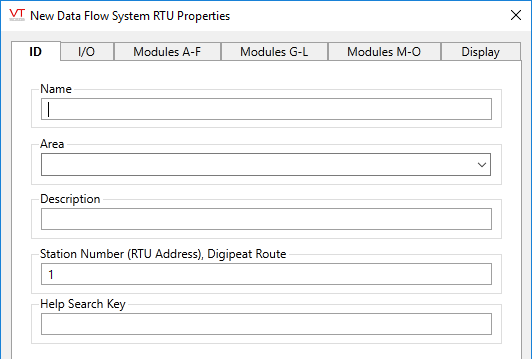

Data Flow RTU Driver properties ID tab
The Data Flow RTU Driver type includes one extra field on the ID tab: The Station number, (also known as the RTU address) and the Digipeat route.
DFS stations can digitally repeat (digipeat) information to work around obstacles that block direct signals. Refer to the
Station Number(, RTU Address), Digipeat Route
The address of the destination station is first, followed by the station addresses of the RTU it passes through. For example, if you want to talk to station 3 through station 5, this field would be
3, 5
The RTU address is shown in brackets because the station number and RTU address can be different. (This is not common, but it does happen.) In this case, the station number is arbitrary and the RTU address configured on the device is the one to use.

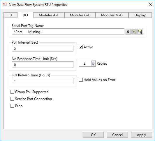

Data Flow RTU Driver properties I/O tab
The I/O tab for a Data Flow RTU driver tag provides properties that can be used to establish a connection between this tag and the physical Data Flow RTU.
Serial Port Name
To connect to this port with VTScada, you can use one of several different hardware solutions:
- Serial port cable connected directly.
For this case, configure and select a Serial Port tag.
- Stand alone serial modem connected to the serial port on the radio.
VTScada has its own modem that is used to dial up the modem connected to the unit. For this option, configure and select a serial port that is using a modem.
- Ethernet terminal server connected to the serial port on the unit.
VTScada is connected to the same network as the terminal server and can connect to it with either a TCP/IP or UDP/IP port tag
Any type of VTScada port tag may be used, but it must match the hardware connection to the unit.
Poll Interval
Enables you to set the amount of time (in seconds or in fractions of a second) between polls of the physical Data Flow RTU.
Note: If the Active check box is not selected, the associated Data Flow RTU will not be polled, regardless of the interval assigned in the Poll Interval (Sec) field.
Active
Specify whether the designated poll interval is active or idle.
If the Active check box is selected, the associated Data Flow RTU will be polled according to the interval assigned in the Poll Interval field.
If the Active check box is not selected, the associated Data Flow RTU will not be polled, regardless of the interval assigned in the Poll Interval field.
The active status can also be toggled by the operator if the tag is drawn as a Comm Status indicator. Right-clicking on that widget will open a menu with which the operator can change the active status. When drawn as a SiteDraw, the outer ring will turn purple when the driver is not active.
No Response Time Limit
Set the amount of time (in seconds or in fractions of a second) that VTScada will wait when an attempt to poll the Data Flow RTU has been made.
If no communication is made, the system will attempt to poll the station again, according to the setting in the Retries spin box. If the system is unable to poll the Data Flow RTU, the next RTU in sequence will be polled.
Retries
Full Refresh Time
Enter a number indicating the amount of time, measured in hours that the system should wait before doing a full refresh of data values from the Data Flow RTU.
Hold Values on Error
Specify whether data should be held in the event of a communications error with the Data Flow RTU.
If the Hold Values on Error check box is selected, the last received value from the Data Flow RTU will be retained otherwise, the data will be invalidated on error.
Group Poll Supported
Select this box to specify whether the Data Flow RTU represented by this tag belongs to a poll group (if group polling is supported by the radio interface module).
Service Port Connection
If selected, The service port enables communication with the RTU via serial devices (such as Lantronix). It is an alternative to using the DataFlow RIM card radio. The DataFlow protocol is slightly different through the service port. Minor differences will be observed, such as all responses being marked as station '0' and the absence of CRCs on messages that would otherwise have them.
Echo
Used if the Service Port Connection option has been selected. Enable or disable according to whether your device transmits an echo for each transmit operation.

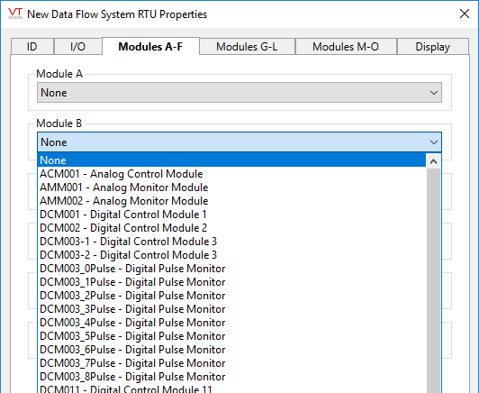

Data Flow RTU Driver properties Modules tabs
The Modules tabs of the Data Flow RTU driver tag properties folder enables you to select existing (or create new) Data Flow module tags to represent the Data Flow modules installed for this RTU (see Data Flow Module Tags). You may associate up to 18 Data Flow module tags with one Data Flow RTU driver.
The modules are divided between the tabs, Modules A-F, Modules G-L and Modules M-0.
Module A, B, etc.
Use the Module fields to identify which module installed at a physical RTU by selecting a Data Flow module tags.
To associate this tag with a set of Data Flow module tags, click the drop-down field to select the appropriate Data Flow module tag for each module.
