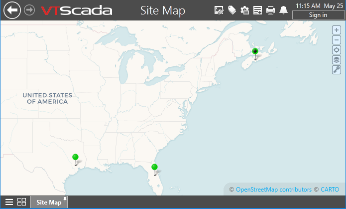

A Site Map is a dynamically-loaded map, primarily used to show the location of any of the site-related tags: Polling drivers, DataFlow RTU drivers, MultiSmart™ stations, MPE™ Duplexer stations, or MPE™ SC stations. You can also link a Context tag (or a user-created type derived from a Context tag) to a map by adding the properties "Latitude" and "Longitude" to the parameter list. A Site Map is a standard part of the menu, and is built into every automatically-generated lift station details page and into the Site Details page. While you can add extra Site Maps to pages within your application using the Site Tools palette or the Menu, it is usually not necessary or beneficial to do so.
In addition to the Site Map page, maps are also an optional part of the Sites page and the Site details page. If viewed in a Sites page, you can choose to add a legend to the map. This is the Site Legend widget, which can be drawn on any of your application pages.
Use the controls at the upper right to zoom or to select the map style.

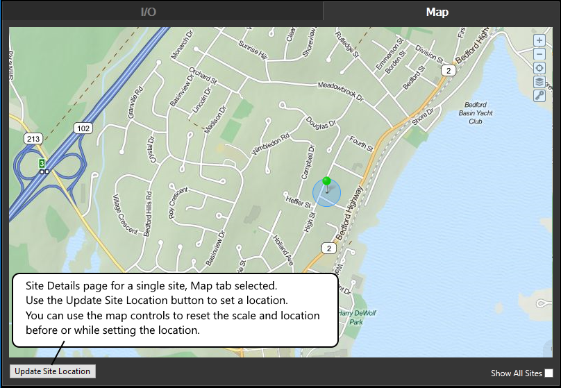

Set the location of a site:
To set the location of a site based on a Context tag, that tag must have Latitude and Longitude properties. See: Add Site Properties. in the description of the Context Tag.
While you could open a tag's configuration panel and type in Latitude and Longitude values, it is usually easier to click a location on the map. In order to do so, you must be viewing a single site using the Site Details page, or by drilling down to the site in the Sites page. When doing so, an Update Site Location button will be provided at the bottom left corner of the map.
The currently selected site is indicated by a pulsing beacon. This is useful when the Show All Sites option is enabled, allowing more than the currently selected site to be seen.

Sites are displayed using markers, either the default pin or a shape of your own creation. Open the Site Map page for a specific tag to access the Update Location button to place or move the site.

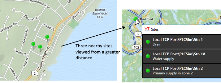

It is typical for sites to be near together. At a close scale, it is easy to tell one from another, but when viewing a larger area, only one pin can be seen.
If sites appear to overlap, a click on the pin icon will open a menu of sites near that location. Choose the site that you want to view in more detail.
The setting SitesPageIconLoadTime is the time interval VTScada waits to see if a particular site icon has finished loading on a map. The default is 0.1. If this is too short, the following symptoms may occur. On a map with many site icons, if any icons overlap, clicking on the overlapping area might cause both of the site pages to open in addition to a site selection dialog. Increasing this timeout to 1 second can alleviate this problem.

The map is sometimes referred to as a "slippy map" because of the way it can be moved within its frame. Operators can pan and zoom to change the area displayed.
The map display is built of "tiles" - static images. At each higher magnification level, four times the number of tiles are used for a given area. As the operator moves the display or changes magnification level, new tiles must be downloaded. After being downloaded, they will be cached locally on your computer. These tiles are not distributed with VTScada, therefore your server must have an active Internet connection to be able to download tiles that have not been cached.
It is possible to switch from map view to satellite view, or to a different map provider. See the task list at the end of this topic.
Any instance of the tag types listed above can be located on a Site Map as a pin. Operators can click on the pin to open the associated Site Details Page. Instructions for create your own pin shapes are provided elsewhere. Refer to the list of tasks at the end of this topic.

| Update Site Location | After clicking this button, the next click within the map area will re-locate the site. |
