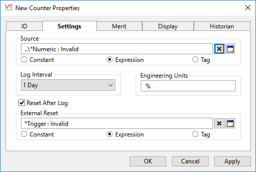

Counter properties Settings tab
All options to configure the counting behavior of the Counter tag can be found in the settings tab.
Source
The source can be any tag or calculation whose value will change between 0 and a non-zero value. The count will be increased each time the source changes from 0 to a non-zero.
Constants are not useful here, but are a standard part of this type of selector.
Log Interval
The Counter tag will log its value at the end of each interval specified. This interval goes by the clock, not by running time. If, for example, the log interval is set to "Day" the tag's value will be logged at midnight, not at the end of 24 hours of operation. If the log interval is set to "Hour" the tag's value will be logged each hour on the hour. "Weekly" means midnight Sunday night and "Monthly" means at midnight before the first day of the month.
Reset After Log
You can select whether the counter should be reset to 0 after its value is logged.
Engineering Units
Text that states what the Counter tag is counting (e.g. Starts).
External Reset
Specify a tag or calculation to force a reset of the counter. Note that the current value of the tag will always be logged before a reset. The reset will occur when this source changes from a 0 or false value to a non-zero or true value. A change from invalid to true does not cause a reset.
