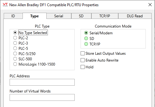

Allen-Bradley Driver properties ID tab
Server List
Allen-Bradley Driver properties Type tab
The Type tab for an Allen-Bradley driver tag properties folder consists of attributes used to identify the type of Allen-Bradley programmable logic controller that this driver will represent.
PLC Type
Select the type of Allen-Bradley PLC that this Allen-Bradley driver tag will represent. This may be one of:
- No Type Selected <default option>
- PLC-2
- PLC-3
- PLC-5
- PLC-5/250
- SLC-500
- MicroLogix 1100-1500
The MicroLogix driver is used in SLC-500 addressing. The TCP/IP port number to use for this driver is 44818.
It may be necessary to adjust the timeout interval on the TCP/IP tab if using MicroLogix.
If using a Rockwell CompactLogix or ControlLogix PLC, use the CIP driver.
Communication Mode
Set the mode to match the linked port.
PLC Address
This field should contain the address of the Allen-Bradley programmable logic controller. One of the following 3 formats is permitted. (Note that this address must be provided in octal.)
- 012 (octal)
- 034 0357 (octal with a bridge address)
- 1.2.3.4 (IP address)
The PLC Address field and the TCP/IP Address fields are linked, and therefore are completed simultaneously. When you enter an address in the PLC Address field, the same address is automatically entered in the TCP/IP Address field on the TCP/IP tab for this tag. Conversely, when you enter an address in the TCP/IP Address field, the same address is automatically entered in the PLC Address field.
Number of Virtual Words
Use this field to specify the number of registers that the virtual PLC will create. The virtual PLC will then emulate a PLC-2 and respond to requests to read and write data.
Store Last Output Values
Enable Auto Rewrite
Hold

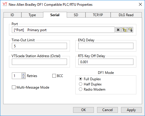

Allen-Bradley Driver properties Serial tab
The Serial tab for the Allen-Bradley driver tag properties folder consists of attributes used to identify and establish a connection the Serial Port tag that the Allen-Bradley driver should use to transmit data to the I/O device. The Serial tab is also used to select the communication protocol and error checking to be used in transmissions of data between the I/O device and the Allen-Bradley driver.
Port
Select the Serial Port tag or TCP/IP tag you wish to be associated with this driver tag. A Serial Port tag opens a serial port to enable communications between VTScada and your PLC or RTU. A TCP/IP tag is used to connect to a series of hosts, allowing you to transmit data across a network or over the Internet.
Right-click on the selected tag to open its properties folder.
Time-Out Limit
Sets the receiver time-out limit (i.e. the time in seconds or fractions of a second that this driver should wait for a reply from the PLC or RTU).
VTScada Station Address (Octal)
Specify the address (using the octal addressing format) of the VTScada system on the serial link.
Retries
ENQ Delay
Specify the amount of time (in seconds or in fractions of a second) that this Allen-Bradley driver should wait before sending an ENQ in half duplex mode.
Note: Half duplex mode refers to the transmission of data in one direction at a time.
RTS Key Off Delay
The RTS Key Off Delay field represents the amount of time (in seconds) that this Allen Bradley driver will wait before dropping RTS at the end of a data transmission.
BCC
Click this check box to select whether the BCC error checking method will be used on communication messages.
By default, the BCC check box is not selected (i.e. CRC error checking is used on all communication messages).
Note: The CRC acronym stands for Cyclic Redundancy Check, and the BCC acronym stands for Block Check Character. Both are techniques used to detect data transmission errors. In general, CRC is a better error checking method, as it is a 16-bit error check, whereas BCC is an 8-bit error check.
Multi-Message Mode
Use only when the driver's Communication Mode is set to Serial/Modem and the DF1 Mode is set to Full Duplex.
If multiple Allen Bradley drivers are sharing the same port, then all drivers using the port must use the same configuration for this setting. Further, all of their "Communication Mode" and "DF1 Mode" settings must match as well.
This option cannot be used if other types of drivers share the same port.
See also: ABDF1IgnoreAckNak, ABDF1SerialMessages
DF1 Mode
Enables you to choose between the following data transmission modes in communications from the driver to the PLC.
- Half Duplex: Half duplex mode refers to the transmission of data in one direction at a time. If the driver and the PLC are communicating using the half duplex mode, either the driver or the PLC may transmit data at one time. The device not communicating must wait until the device that is transmitting data is finished before it can transmit its data.
- Full Duplex: Full duplex mode refers to the transmission of data by both parties simultaneously.
- Radio Modem: Certain Allen Bradley PLCs use the Radio Modem Protocol (RMP) to optimize DF1 communication on radio modem links. The protocol is an enhancement of the Full Duplex Protocol and uses the same message format with all the ACK and NAK responses removed.

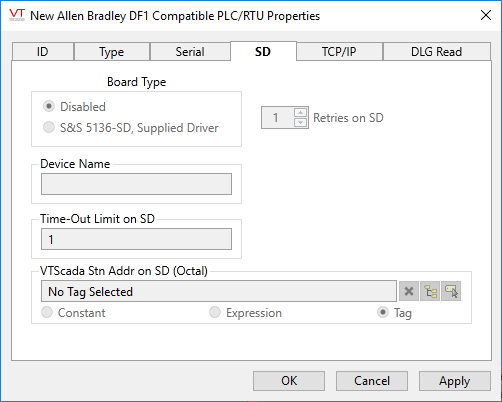

Allen-Bradley Driver properties SD tab
The SD tab for the Allen-Bradley driver tag properties folder consists of attributes used to identify and establish a connection to the SD I/O board, if one has been configured for this I/O device.
Board Type
Specify the type of I/O board that has been installed. This can be one of:
- Disabled - When selected, indicates that the I/O board for this driver is disabled.
- S&S 5136-SD, Supplied Driver - When selected, indicates that a 5136-SD card is installed.
Device Name
The name of the device being monitored by this tag. This is a unique name that must be entered exactly as it appears in the Windows® Device Manager’s devices list.
Note: To launch the Device Manager in Windows, click Start, and then click Control Panel. Double-click System. On the Hardware tab, click Device Manager.
Time-Out Limit On SD
Set the amount of time (in seconds or in fractions of a second) that the driver will wait for a reply from the PLC's SD card.
Retries On SD
Select the number of retry attempts you wish to be made by the driver if there is no response to a message
VTScada Station Address On SD (Octal)
Specify the address of the VTScada system on the SD link. This value must be in Octal format.
The address may be set via a constant value, an expression or a numeric tag whose value is the octal address.

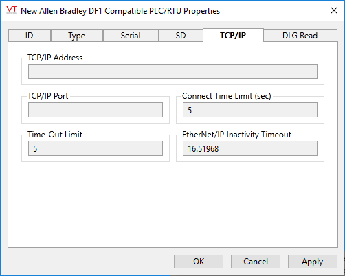

Allen-Bradley Driver Tag Type properties TCP/IP tab
The TCP/IP tab of the Allen-Bradley driver tag properties folder can be used to configure the address, port, and time limit to be used if communications are to be made using the TCP/IP communications protocol.
TCP/IP Address
The TCP/IP Address field is used to specify the port number through which this Allen-Bradley driver tag will communicate.
Note: The TCP/IP Address field and the PLC Address fields are linked, and therefore are completed simultaneously. When you enter an address in the TCP/IP Address field, the same address is automatically entered in the PLC Address field on the Type tab for this tag. Conversely, when you enter an address in the PLC Address field, the same address is automatically entered in the TCP/IP Address field.
TCP/IP Port
The TCP/IP Port Number field refers to the port number on the host address through which communications are enabled. This information should be available from your hardware specification. The default value depends on the PLC Type selected. 2222 or 44818 are typical values.
Connect Time Limit
Use the Connect Time Limit field to set the amount of time (in seconds or fractions of a second) that the driver will await responses from the PLC. Defaults to 5 seconds unless otherwise specified.
Time-Out Limit
Specifies the time to wait for the PLC to respond after connection. This is the same as the timeout on the Serial tab.
Ethernet/IP Inactivity Timeout
Applies only if the PLC Type is set to MicroLogix. The maximum network link inactivity time in seconds. If there is no communication between VTScada and the PLC for this duration, VTScada will shut down the TCP/IP socket connection to the PLC. This setting can be used to automatically terminate connections to PLC that are polled infrequently to reduce network traffic. The TCP/IP connection is automatically re-established by the driver when the PLC polling is resumed.
- Inactivity timeout < I/O polling time will cause the session to timeout between polls
- Inactivity timeout > I/O polling time will cause the session to remain open between polls
- Inactivity timeout = polling time should be avoided.
Retries

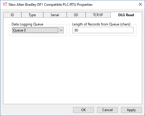

Allen-Bradley Driver properties DLG tab
Certain Allen Bradley PLCs (of PLC Type "MicroLogix") can log time-stamped data into files in PLC memory.
The Allen Bradley Driver tag can read records from these files (referred to here and in the PLC documentation as queues). In order for the Allen Bradley Driver tag to make use of this feature, both the tag and the PLC must be configured properly. The DLG Read tab of the Allen Bradley Driver tag can be used to configure the tag for this feature. Refer to the PLC's manual for instructions on how to configure the PLC (noting that up to 256 queues can be created and data from different PLC memory addresses can be logged into different fields in different queues).
Data Logging Queue
Use to select a queue (configured according to the PLC’s manual) from which the driver will be retrieving logged data.
Length of Records from Queue
Enter the length of the records in the queue selected in the Data Logging Queue drop list. This value is the length (in characters) of the records in the queue after they are converted into a string by the PLC for communication.
The valid range is from 1 to 80. The value must be calculated according to how the data logging queue was configured in the PLC itself:
- 11 characters for the date field,
- 9 characters for the time field,
- 12 characters for each long integer field
- 7 characters for each short integer field.
By default, the Allen Bradley Driver tag will assume a length of 80 chars (the maximum allowed by the PLC). While the default value will work, this may impose a penalty on the amount of communication between the driver and the PLC. Entering the exact length is therefore recommended.
Note: entering an incorrect value will most likely result in failure to read any records from a particular queue, therefore you should only change the default value if you know the exact value.
