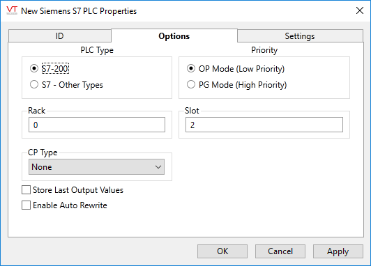

Siemens S7 Driver properties Options tab
The Options tab for the Siemens S7 driver tag properties folder consists of attributes used to identify and establish a connection to the control device to be associated with this driver.
PLC Type
Address parsing differs for the S7-200 device. For all other S7 devices, choose the option, "other".
Priority
Two priority levels are available: OP Mode (low priority) and PG Mode (high priority). Note that there may be a limit on the number of PG mode connections which are available.
Rack and Slot
Specify the CPU position. These can be determined from the hardware configuration. Note that these fields do not apply to the S7-200 CPU.
CP Type
If you are connecting to a Siemens PLC through a communications processor, select it here, otherwise select None.
Options include: CP-243, CP-343 and CP-443.
Store Last Output Values
When selected, the driver will maintain a record of the last value written to each output address. This may be useful in at least two situations:
- For hardware that does not maintain its state during a power loss and must be restored to that state when re-started.
- When failed hardware is replaced by a new device and you would like to start that device with the values last written to the old one.
If the last output values are stored, they may be re-written by either of two methods:
- Automatically, when communication is restored to the device.
- Manually by way of a button press. See, Rewrite Outputs Widget for details.
Changing this value from selected to deselected will cause all stored values to be erased immediately.
If this driver is being used in conjunction with a Driver Multiplexer, then configure the Driver Multiplexer to store the last values, not the drivers connected to the Multiplexer. In this case, only the Multiplexer should be configured to re-write automatically.
Enable Auto Rewrite
If selected, the Store Last Output Values option will also be activated. This option causes the driver to rewrite the last value written to each output, in the event that communications are lost and then restored.
Use this option only if you are certain that you want the last values to be rewritten automatically after an interruption in driver communications.

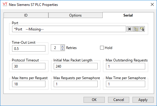

Siemens S7 Driver properties Serial tab
The Serial tab for the Siemens S7 driver tag properties folder consists of attributes used to identify and establish a connection to the control device to be associated with this driver.
Port
Since the only protocol available is ISO over TCP, you should configure and select a TCP Port.
Time-Out Limit and Retries
A half second time out limit with one retry is recommended as a reasonable value for a Siemens PLC.
Retries
The number of times to retry a message before declaring an error.
Use only if the driver is connected to a Serial port. When using TCP/IP, do not set to any value other than 0.
Hold
Check this to have I/O tags attached to the driver hold their last value in the event of a communication failure. If not checked, tags will have their value set to invalid on a communication failure.
Protocol Timeout
Timeout period, after which a lack of protocol traffic is considered an error. Default: 30 seconds.
Initial Max Packet Length
Maximum PG/OP packet length used for initial communication with the PLC. This value will not be used after length negotiation with the PLC is complete. Default: 240.
Max. Outstanding Requests
Defines the maximum number of PG/OP packets that may be outstanding. Default: 1 outstanding request.
Max Items Per Request
Defines the maximum number of item addresses to include in a request. Default: 18 items.
Max Requests per Semaphore
Defines the maximum number of requests that can be sent in one semaphore acquisition. Default: 100 requests.
Max Time per Semaphore
Defines the maximum amount of time to hold the semaphore. Default: 1 second.
The following widgets are available to display information about your application’s Siemens S7 driver tags:
