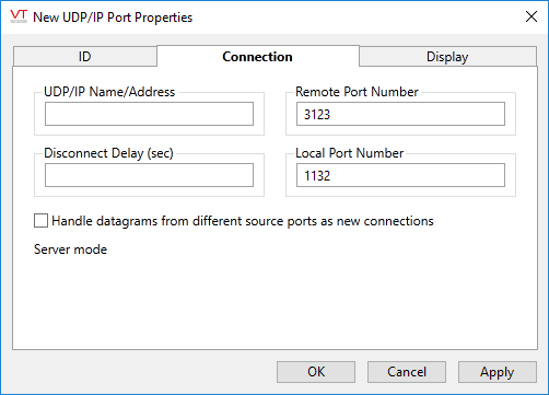

UDP/IP Port properties Connection tab
The Connection tab of the UDP/IP port tag properties folder contains properties that enable communications.
If the UDP/IP Name/Address field is blank, then behavior will depend on the configuration of the Report Port Number and Local Port Number as follows:
Report Port Number and Local Port Number configured:
The tag will be a listener on the port and any inbound datagrams will sit in a bi-directional stream (i.e. a driver can both read and write to the stream). Writes to the stream cause datagrams to be issued to the device that originated the inbound datagram that created the stream and are transmitted to the "Remote Port Number" on the device.
Report Port Number blank and Local Port Number configured:
The tag will be a listener on the specified local port.
Report Port Number blank and Local Port Number blank:
The tag will do nothing.

If running in server mode (the UDP/IP Name/Address field is empty)
LABEL: "Handle datagrams from different source ports as new connections"
A UDP "stream" is initially created when the first datagram is received from the remote device. For subsequent datagrams:
- If the remote device sends a datagram from the same port as the previous one, the datagram will appear in the same stream as the first one. Leave the check box unselected.
- If the remote device sends a datagram from a different port as the previous one, then:
- Check box selected: A new stream is created into which the datagram will be placed.
- Check box NOT selected: The datagram is placed in the existing stream.
This has significance when the driver using the UDP port attempts to transmit using the existing stream. When the check box is selected, the stream is associated with a specific port on the remote device and will be sent there. When the check box is NOT selected, it will be sent to the port on the remote device that issued the datagram that created the stream.
