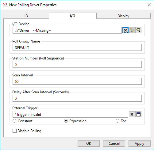

The I/O tab for the Polling Driver tag consists of properties used to identify the communication driver tag to be associated with this polling driver, and to establish the poll group, the I/O device's sequence in the poll, and the interval at which the equipment associated with the communication driver tag should be polled for data.
I/O Device
The I/O Device field enables you to specify the communication driver tag for which this polling driver will set the scan rate.
The I/O Device field can be used to associate this tag with a new or existing communication driver tag using the tag browser button. The button opens the Tag Browser, which displays only the existing communication driver tags for your application, and enables you to create a new communication driver tag using its New button.
Poll Group Name
Optional. If you have several Polling Drivers with similar configurations and especially if those drivers use the same port (possibly a radio) you may create an association between them by creating and assigning the same group name to all. There are several use-cases for this, as described in Polling Groups and Scan Intervals.
Poll Sequence Number
Relevant only if you have used the same Poll Group Name for several Polling Drivers, and if those drivers are configured with the same Scan Interval and Delay After Scan.
Because the interval and delay are the same, all drivers are placed on the group's "to-be-polled" list at the same time. The Poll Sequence Number specifies this driver's place in the sequence for the identified group. See: Polling Groups and Scan Intervals
Scan Interval (Seconds)
When the scan interval is reached, the driver is placed back on the "to-be-polled" list. For example: If, as a result of slow communications, it takes 10 seconds to poll a station, a driver with a one-second scan interval can scan only once every 10 seconds. But, thanks to its one-second scan interval, it is placed back on the list immediately after each interval passes, and will be next in line for the following round of scans.
If the Scan Interval is set to 0, the I/O device is scanned for data as fast as is possible, defaulting to 1 second. Note that Polling drivers were designed for use with radio communication, therefore the fastest possible scan interval is one second. Faster intervals do not make sense for the intended purpose. If you require scan intervals measured in fractions of a second, configure those directly within your I/O tags and do not use a Polling driver to control timing.
Delay After Scan Interval (Seconds)
Sets a delay after the Scan Interval, which must pass before the driver is added back to the "to-be-polled" list. See: Polling Groups and Scan Intervals
External Poll Trigger
May be linked to any tag or expression that transitions from a 0 or invalid state to a 1-state to trigger a poll. A Trigger Tag should be used here, if you want to schedule polling to occur on a given schedule or in response to an operator’s command. Note that an external poll signal will not cause a poll to occur if polling is disabled, or if fast scan mode is enabled.
Disable Polling
Use to disable or re-enable the polling cycle for this poll driver. This does not mean that reads or writes are disabled because only the polling cycle is affected. A Toggle Polling Button widget can be drawn in your application to allow operators to change this value at need.

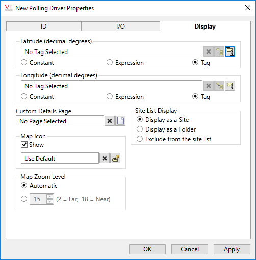

The Display tab is used to define the placement (latitude and longitude) of the Polling Driver station. Decimal values should be used rather than degrees, minutes and seconds.
You may find it easier to set the location using the map interface than to enter the latitude and longitude values here. See: Site Map.
Latitude and Longitude
Holds location coordinates for this tag, thereby allowing it to be represented on a Site Map page.
Custom Details Page
If a custom details page has been created for this context tag, then that page should be selected here. If there is no custom details page, then operators will see the standard Site Details page upon clicking the pin for this tag in a Site Map.
Advanced Configuration:
The default page selection dialog has a filter for "all pages" or "site pages", meaning those that take a site tag as the first parameter.
You can add either of the following two properties in the Edit Properties page of the Application Configuration dialog to restrict this filter:
LimitPageListToSitesPages
System section. Set to 1 (TRUE) to prevent access to the "all pages" option in the page selection dialog for all users.
LimitPageListToSitesPagesIfRealmUser
System section. Set to 1 (TRUE) to prevent access to the "all pages" option in the page selection dialog if the user belongs to a security group.
Custom Map Icon
If a custom map icon widget has been defined, you can select it here. That icon will then be used instead of the standard pin when this tag is represented on a Site Map page. If there is no custom map icon, then the standard pin will be used.
Site List Display
Assuming that this tag has site properties, it will be included in the list of a Sites page. What will happen when an operator clicks on this tag in that list depends on the Site List display choice, and on whether any of this tag's children are I/O tags.
- Display as Site: A click will open the Site Details page as a pop-up.
- Display as Folder: A click will leave focus on the Sites page, but the list will now show the child tags of this site.
- Exclude: This tag should not be shown in the Sites page list.
Map Zoom Level
If Automatic is chosen (the default) then when a map is opened, showing only this site, it will zoom to level 15, which shows only the immediate surroundings. You may select any value between 18 (the closest possible level) and 2 (showing the entire globe).
