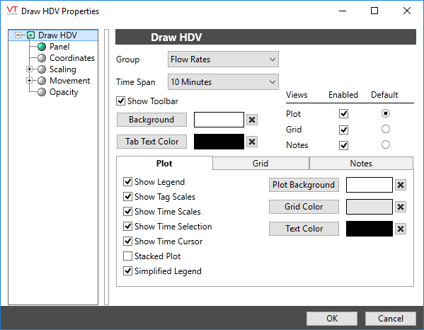

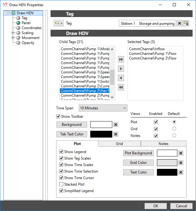

The properties dialog for the Draw HDV will vary, depending on whether it is linked to a type or using a named pen group.
Linked to a type.
Using a pen group
Tag (If linked to a tag)
The selected context or type, if not using a pen group.
Child Tags (If linked to a tag)
If using a linked tag rather than a named group. The list of child tags of the selected parent that could be plotted, but have not yet been selected.
Selected Tags (If linked to a tag)
If using a linked tag rather than a named group. The list of tags that have been selected to be shown in the HDV widget.
Group (If not linked to a tag)
Select an existing pen group to display.
Time Span
Select the length of time to display in the HDV. Options match those in the full HDV page, ranging from one second to five years.
Show Toolbar
When selected, the full set of HDV tools will be displayed across the top of the widget. The toolbar does not scale, therefore if the widget is not wide enough to show all the buttons, those on the right will be lost.

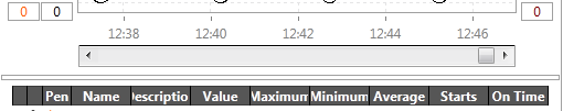

Show Time Selection
When selected, the HDV's time scroll bar will be added between the graph and the legend.

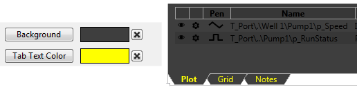

Background Color and Tab Text Color
Sets the background and tab-text colors of the overall widget. (Plot, grid and other text colors are set in the following section.)

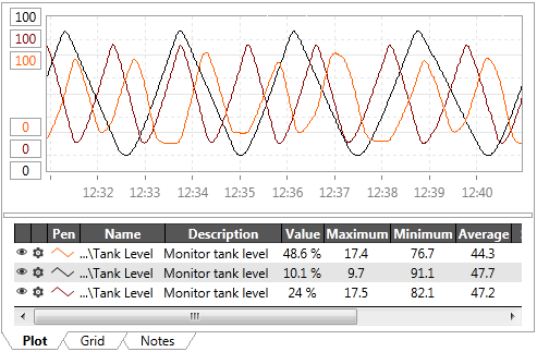

Plot View Options
Options as shown to control what will be included in the plot view of the HDV display, including:
- Choice of color for the background, grid lines and numeric scale. The "X" beside the color choice will reset each value to the default color.
 - Options to display the legend, tag scales, time scales, stacked plots.
 - Option to display a full legend including statistics or simplified legend of tag identification and values only.
 - Option to show the time cursor (vertical line following the pointer).
