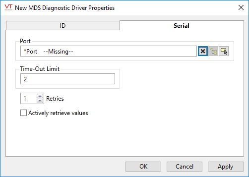

MDS Diagnostic Driver properties Serial tab
The Serial tab of the MDS diagnostic driver tag properties folder is used to indicate the serial port to which the MDS radio associated with this tag is connected.
Port
The Port field enables you to select the Serial Port tag or TCP/IP tag you wish to be associated with this driver tag.
In order to connect to MDS radio port with VTScada, you can use one of several different hardware solutions:
- Serial port cable connected directly.
For this case, configure and select a Serial Port tag.
- Stand alone serial modem connected to the serial port on the radio.
VTScada has its own modem that is used to dial up the modem connected to the radio. For this option, configure and select a serial port that is using a modem.
- Ethernet terminal server connected to the serial port on the radio.
VTScada is connected to the same network as the terminal server and can connect to it with either a TCP/IP or UDP/IP port tag
Any type of VTScada port tag may be used, but it must match the hardware connection to the radio.
Time-Out Limit
Set the time in seconds or fractions of a second that this driver should wait for a reply from the remote unit.
Retries
Actively Retrieve Values
Indicates that messages should be sent out in active mode, rather than passive mode.
If the Actively Retrieve Values check box is selected, messages will be sent out in active mode (i.e. a request for data from the MDS radio will be immediately sent).
If the Actively Retrieve Values check box is not selected (default), the data will be sent out in passive mode (i.e. a request for data from the MDS radio will be held until another request for data from the associated RTU or PLC is made).
