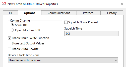

Comm Channel
Choose the format of the outgoing messages. Serial RTU sends the messages as they are and includes a CRC
Cyclic Redundancy Check at the end. Open Modbus TCP prefaces the messages with a TCP header. Note that the comm channel setting can be changed independently of the port tag. For example, some devices use the Serial RTU protocol sent out over a TCP/IP port.
Squelch Noise Present
Applies when communicating over a radio modem. Select this box to enable squelching of background noise.
Squelch Time
The number of seconds to wait before clearing noise when the Squelch Noise Present option has been selected.
Store Last Output Values
Enable Auto Rewrite
Device Clock Time Zone
The time zone of the clock in the Enron Modbus device. This is used to correct the time-stamped values read from the device by VTScada for storage in its historian using UTC format. Regardless of the time zone selected with this option, the driver assumes that the device does NOT adjust its clock for daylight savings time (DST).
- Uses Server Time Zone (no DST) - assumes that the device is in the same time zone as the server.
- Device Clock In UTC - the clock in the device is set to UTC
- Actual Time Zone - select the time zone where the device is located.

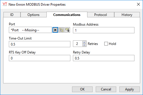

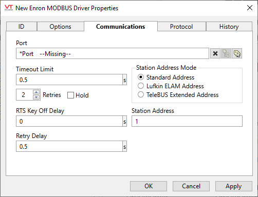

Enron Modbus Driver Configuration - Communications
Port
The port tag through which this driver communicates to a device, usually either a serial port tag or a TCP/IP tag.
Time-Out Limit
The length of time, in seconds, that the driver should wait for a reply from the device.
Retries
Hold
RTS Key Off Delay
Used for serial communications, this field represents the length of time in seconds that the device will wait before dropping RTS at the end of a data transmission.
Modbus Address
The Modbus address of the Enron Modbus device.
Retry Delay
The length of time, in seconds, that the driver will wait between retry attempts if there is no reply to the initial message.

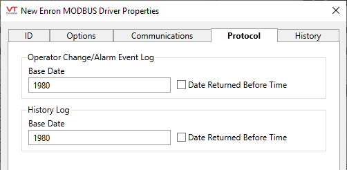

Enron Modbus Driver Configuration - Protocol
Operator Change / Alarm Event Log...
Base Date
When operator-change or alarm-event-log, time-stamped data is returned from the device, the year is provided as a two-digit number. That number is then added to this base date to produce the actual date used for the timestamp. for example, if the number returned was "34" and the base date is "1980" then the year will be recorded as 2014. This information should be available in your device's documentation.
Date Returned Before Time
Usually operator-change or alarm-event-log time-stamps from the device are returned with the time being sent before the date. If the reverse is true for your device then this box should be selected.
History Log...
Base Date
When history log time stamped data is returned from the device, the year is provided as a two-digit number. That number is then added to this base date to produce the actual date used for the timestamp (e.g. if the number returned was "34" and the base date is "1980" then the year will be re-corded as 2014. This information should be available in your device's documentation.
Usually, history-log time-stamps from the device are returned with the time being sent before the date. If the reverse is true for your device then this box should be selected.
Enable Multi-Write Function
Although standard Modbus multi-write function codes are not defined as part of the Enron Modbus standard, some devices can make use of them. If this is true of your device, this box may be selected.

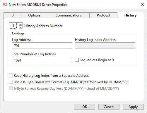

Enron Modbus Driver Configuration - History
The Enron Modbus protocol allows for the retrieval of historical data records stored in the device. Each record holds the value of several variables for a specific timestamp, ordered by an incrementing index value. The following table is a representation of a theoretical hourly history log.
| Index | Date | Time | Temperature | Pressure | Flow |
| 1 | 08/08/2014 | 08:00:00 | 21.3 | 87.2 | 48.4 |
| 2 | 08/08/2014 | 09:00:00 | 22.4 | 86.9 | 49.4 |
| 3 | 08/08/2014 | 10:00:00 | 25.1 | 87.3 | 48.7 |
| 1024 | 27/06/2014 | 19:00:00 | 18.9 | 87.4 | 44.0 |
Every hour, a new record is created inside the device. After the final history register has been filled (in this case index 1024) the next record goes back to index 1 and overwrites the record stored there.
The History tab is used to define and to track the characteristics and status of the device's history log. The "table columns" that are to be logged should be defined here. Up to 30 log tables may be defined.
History Address Number
Select which of the 30 separate history addresses to configure.
Log Address
The register address in the device where the history log is stored. For the first flow run, this is usually either 701 (for hourly history) or 702 (for daily history).
Default values of 701 through 710 are provided for History Address Numbers 1 through 10.
History Log Index Address
Some devices track the position of the index of the next record to be written. The address where this index position is stored should be entered here. This field is only used if the Enron driver's Read History Index from a Separate Address box is selected.
Total Number of Log Indices
The total number of records stored in the history log. After the driver has read this many indices it will start back at the first index.
Log Indices Begin at 0
Select this box if the first index of your device is 0 instead of 1.
Read History Log Index from a Separate Address
Historical data is read from a table in the device, which is ordered by an index value. By default the Enron Modbus driver will read all indices sequentially until arriving at the end of the new data (according to the datum's timestamp), however some devices track the most recent index value internally in a separate register. If this is the case with your device then this box should be selected. Note that the actual index register is set as part of the Enron History tag.
Use a 6-Byte Time/Date Format
The Enron Modbus protocol it returns the time and date from history logs as a pair of 4-byte floats. Some RTUs will instead return those as six 1-byte integers (MM/DD/YY followed by HH/MM/SS).
6-Byte Format Returns Day First
Enabled only when the preceding option is selected. Returns a 6-byte date format as DD/MM/YY instead of MM/DD/YY.
