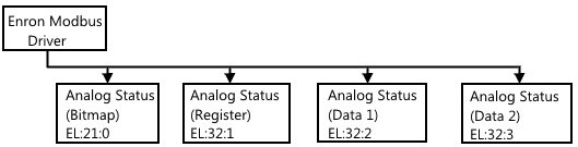

Along with the timestamp, four pieces of information are returned as part of each event/alarm. Each of these pieces of information should be captured in its own analog status tag with the address:
EL:x:y
where x is the address of the alarm log (usually 32) and y is a value between 0-3 based on the chart following.

The diagram following details the tag setup. Contrasting this with the diagram of the historical log, you can see that no intermediary tag is necessary between the driver and the status tags. However, you may still choose to add a context tag to group the four analog status tags together.
