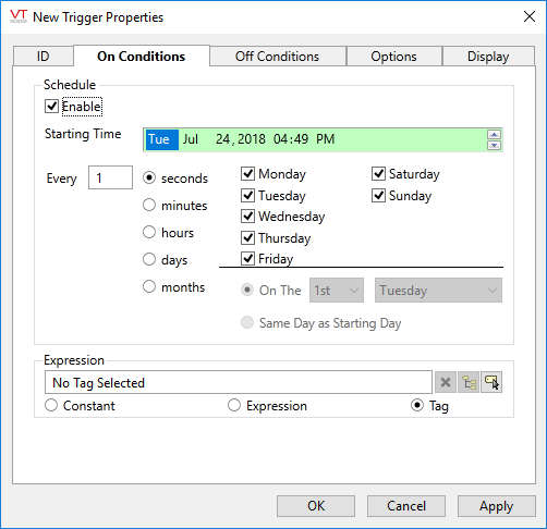

Trigger tag properties: On Conditions tab
This tab is used to set the condition that will switch the tag’s value to 1. The tag may be switched to an ON state based on a schedule or based on an expression (which may include a tag).
Both options may be configured, resulting in a tag that will be triggered both on a regular schedule and also in response to an event.
Note the field labeled "Enable". When not selected, this means that no schedule is in effect. All other time-related fields will be disabled.
Note also the Starting Time. This serves as both an initial trigger time and the base date for repeating trigger events. For example, to trigger a report to be created at midnight on the first day of each month, you would set the following values:
- "Enable" field selected.
- "Starting Time" set to 12:00 a.m. on the first day of this month.
(Setting the first day of next month would achieve the same result, but putting the base date of repeating events in the past ensures that you do not miss the first iteration.)
- "Every" value set to 1.
- "Months" option selected.
- "Same Day as Starting Day" selected. ("Same Day" refers to date in the month, not day of the week)
You must also configure the Off Conditions tab to set the schedule or condition that will reset the tag’s value to 0. After the trigger has occurred and the tag’s value set to 1, it remains at a value of 1. If you need a 0 to non-zero transition to trigger an event, you must reset the value to Off (0) before the next desired On-time.
Enable
Must be selected in order for the trigger to activate based on a time and date schedule.
Starting Time
Sets the base date and time for the schedule configuration options. Subsequent configuration options will be counted from this start time. If set to the future, no trigger will occur until that date.
Every [N] Seconds / Minutes / Hours / Days
The field beside "Every" controls the frequency of the following units.
For example, if the Every value is set to 1 and the Hours check box is selected, then beginning with the time configured in the Start Time, the trigger will be set to true every hour.
If the Every value is set to 7 and the Days check box is selected, then beginning with the configured Start Time date, the trigger will be set to true every week at the time given in Start Time.
Day check boxes
Allow you to control which days the Trigger tag will operate on. For example, you may choose to disable the trigger’s action on weekends by deselecting Saturday and Sunday.
These check boxes will not be enabled when the Months option is selected.
Months
Selecting the Months option is similar to configuring to Trigger tag to switch on every N Hours. If this option is chosen, then further refinements include "On The" or "Same Day as Starting Day".
For example, you may wish to configure the trigger to run "on the 1st Wednesday" or "on the 2nd Monday" of the month. Alternatively, of you have selected "Same Day as Starting Day" then the trigger will run on the given numeric day of the month, at the selected time.
When the Months option is selected, the Day check boxes will not be enabled.
Expression
Select a tag, or enter an expression that will be used to activate the Trigger tag. The On condition will be set when the selected tag or expression’s value becomes non-zero.

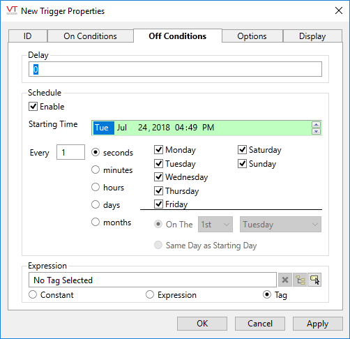

Trigger tag properties: Off Conditions tab
This tab is used to set the condition that will switch the tag’s value to 0, resetting the Trigger tag for the next scheduled event. The tag may be switched to an OFF state based on a delay in seconds after switching ON, a schedule, or based on an expression (which may include a tag).
A combination of options may be configured, resulting in a trigger that will reset either based on time, or in response to an event.
Note the field labeled "Every". When set to 0 this means that no schedule is in effect. All other time-related fields will be disabled.
Delay
When set to a value greater than 0, the Trigger tag’s value will be set to 0 (OFF) this many seconds after being triggered by the On Condition.
Enable
Must be selected in order for the trigger to de-activate based on a time and date schedule.
Starting Time
Used to set the base date and time for the reset (Off-condition) schedule. The other configuration options on this tab will be counted from the given Starting Time.
For example, if the Every value is set to 1 and the Hours check box is selected, then beginning with the time configured in the Start Time, the trigger will be reset to 0 every hour.
If the Every value is set to 7 and the Days check box is selected, then beginning on the configured Start Time date, the tag will be reset to 0 every week.
Day check boxes
Allow you to control which days the reset schedule will operate on. For example, you may choose to not reset the tag to 0 on weekends by deselecting Saturday and Sunday.
Months
Configures the tag to reset to 0 every month. If this option is chosen, then further refinements include "On The" or "Same Day as Starting Day".
For example, you may wish to configure the trigger to reset "on the 1st Wednesday" or "on the 2nd Monday" of the month. If you have selected "Same Day as Starting Day" then the trigger will be reset on the given numeric day of the month, at the selected time.
Expression
Select a tag, or enter an expression that will be used to reset the Trigger tag’s value to 0. The Trigger tag’s value will be set to 0 when the value of the selected tag or expression becomes non-zero.

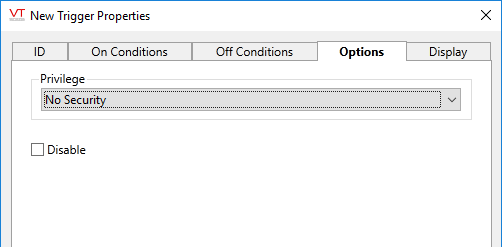

Trigger tag properties: Options tab
A trigger tag may be drawn as a button on a page, thus allowing operators to trigger the associated action at unscheduled times, if required. By adding a custom privilege, you can restrict access, allowing only authorized users to use the button.
Select the Disable option to deactivate the Trigger tag. Disabling a Trigger tag forces its value to 0.
Protect Pages and Output Tags - Create your own privileges for protection.

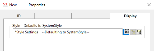

Trigger tag properties: Display tab
The following widgets are available to Trigger tags:
Equipment / Status Color Indicator
Of these widgets, only the Set Value Button, Set Value Hotbox Widget, and Momentary Button Widget methods enable users to output values to the associated tag. The remaining widgets display the value of the tag.
