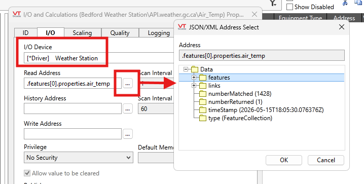

Data may be read by attached I/O tags such as Analog Status, Digital Status or String I/O as appropriate. The address will depend on the structure of the JSON or XML file, therefore an Address Assist dialog is provided. All I/O tags linked to this driver will gain an address assist button automatically. The contents of the resulting dialog will be populated from the file. If the file cannot be read for any reason, then no addresses will be available.

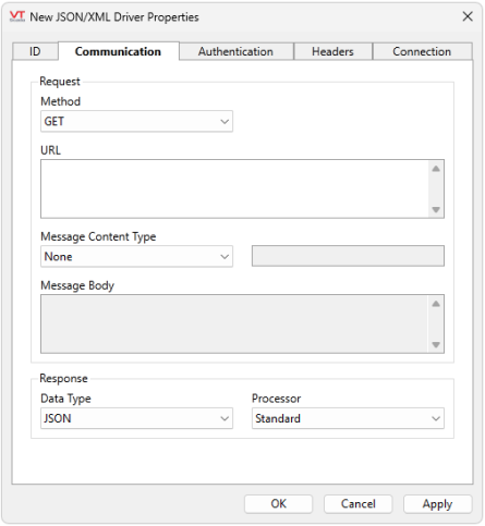

URL
This is the address of the file containing either JSON or XML-formatted data to be read by the driver.
Use the selector below the address to specify which of the two supported data types will be found at this URL. If the URL does not specify a port number, then it will default to 80 for unsecured connections and 443 for secured connections.

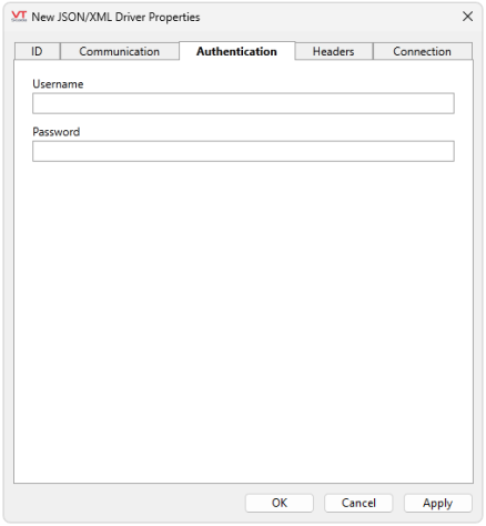

Username and Password
If required by the remote system, provide the Username and Password required to access the file. Note that the password will displayed as "***" characters and will be stored in an encrypted form.

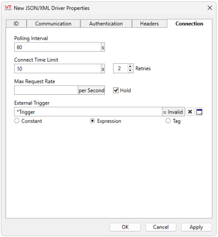

Polling Interval
Set the frequency in seconds for fresh reads of the URL. This defaults to 60 seconds.
Processor
The name of a JSON/XML processor. Standard (the default processor) supports live values being read from the site, but does not provide support for timestamped historical data, forecast data, or dynamic data where the payload structure can change. For these cases, you can write your own processor that will handle complex data structures. See: Write a JSON/XML Processor
Connection Time Limit (s)
Sets the time in seconds that the driver will wait for a response before it gives up and retries or sets an error if all retries have been attempted.
Retries
Max Request Rate (per second)
The maximum number of requests to send per second to the host. The default is an unlimited rate.
A limited rate is necessary for situations where a host may reject a client if it has received more than X requests per second from that client.
Typically, all driver instances that use the same host would be configured with the same Max Request Rate, but this is not required. Each driver will enforce only its own specified rate limit.
Hold
External Trigger
Optionally, specify a tag or expression that will cause a fresh read of the URL to be performed.

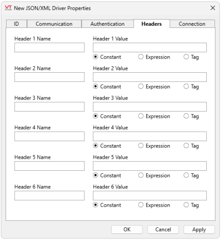

JSON/XML Driver properties Extra HTTP Headers tab
Some URLs may require extra information such as tokens, form data, etc. Use this tab to specify name=value pairs to be added to the JSON or XML URL. Values may be specified here, or supplied from expressions or tags.
