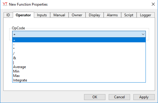

Function properties Operator tab
The Operator tab identifies the operation that will be performed on the inputs for this tag.
OpCode
The OpCode drop-down list enables you to specify the type of operation to be performed on the values associated with this Function tag.
The parameters (values) that will be used for the selected operation, are configured on the tab, Inputs.
- Parameters that are not configured have no impact on the resulting value of the function.
- Parameters whose value evaluates to Invalid will cause most function operations to return Invalid.
The supported operations are:
+ | All configured parameters are added. Any parameter that contains a tag or expression that evaluates to Invalid will result in the Function tag having the value, Invalid. |
- | Parameter 1 - Parameter 2 - Parameter 3 - Parameter 4 (disregarding any unconfigured parameters). Any parameter that contains a tag or expression that evaluates to Invalid will result in the Function tag having the value, Invalid. |
* | Parameter 1 * Parameter 2 * Parameter 3 * Parameter 4 (disregarding any unconfigured parameters). Any parameter that contains a tag or expression that evaluates to Invalid will result in the Function tag having the value, Invalid. |
/ | Parameter 1 / Parameter 2 / Parameter 3 / Parameter 4 (disregarding any unconfigured parameters). Any parameter that contains a tag or expression that evaluates to Invalid will result in the Function tag having the value, Invalid. |
Logical AND. Three results are possible: TRUE, FALSE or Invalid. |
| | Logical OR. Logical Three results are possible: TRUE, FALSE or Invalid. * If any configured parameter is TRUE, then the result will be TRUE. * If all configured parameters are FALSE, then the result will be FALSE. * If no configured parameters evaluate to TRUE, but at least one evaluates to Invalid, then the result will be Invalid. |
Average | Average of Parameters 1 through 4 (excluding any undefined values). |
Max | Maximum of Parameters 1 through 4 (excluding any undefined values). |
Min | Minimum of Function Parameters 1 through 4 (excluding any undefined values). |
Integrate | Performs time integral of Parameter 1 * Parameter 2, every Parameter 3 seconds. * If Parameter 2 is not defined, it defaults to a value of 1. * If Parameter 3 is not defined, it defaults to a value of 1 second. For example, if Parameter 2 and Parameter 3 were not defined, the calculation would be Parameter 1 * 1 every 1 second). |

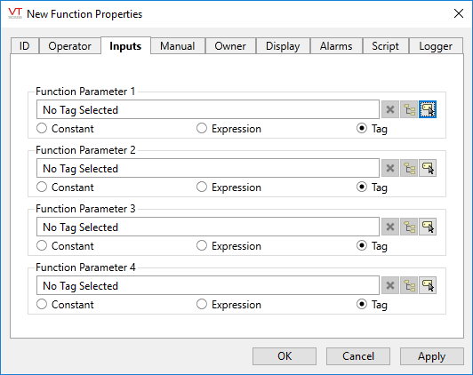

Function properties Inputs tab
The Inputs tab identifies the numeric values or tag values that will be factors in the calculation.
Function Parameter X
The Function Parameter 1 through to Function Parameter 4 fields enable you to specify up to four factors in the calculation performed by this tag.
You may use a constant, expression or tag as the source of the value for each parameter. Parameters that are not configured are essentially ignored, in that they will not have an effect on the result of the calculation.
Parameters that are configured, but which evaluate to Invalid, will have an effect on the calculation as noted in the description of each operational code. Note that tags can have an invalid value when there is an error in communication. Many expressions can return a value of Invalid. For example, if attempting to divide by zero.
You cannot select a Function tag as one of its own function parameters.
